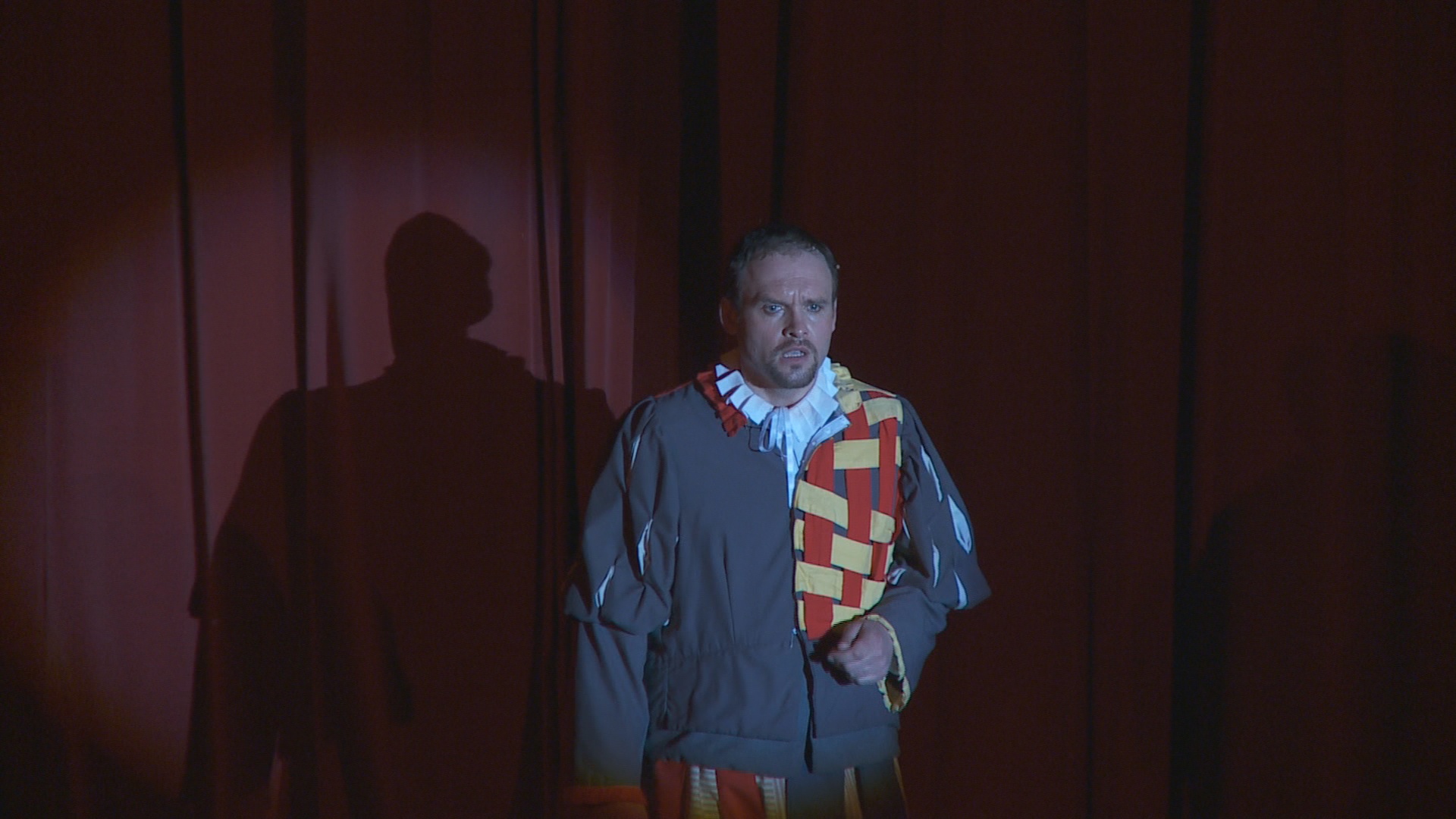

Screengrabs with detail on
Armlock is 720/50p
Guy on stage is 1080 50i SP.
When using the detail-feature?-act-2-scene-2.jpg   When using the detail-feature?-image6.jpg
Round 2
GH5,FZ2000

I can quite clearly see the false edges due to sharpening, look at any area of high contrast - in the V of the leg top left of frame there's an obvious sharpened edge with the telltale black line. Or the black ringing around the addidas logo.
With this particular image though the areas of contrast are quite low, if you had specular highlights (a watch or something) the ringing off that, for me, would be unacceptable. If you're keying or needing to do something to the image then this enhancement is detrimental as well.
I would personally still choose to shoot with no detail 'enhancement' and have that choice later on should i desire it. I would imagine that post based sharpening is more controllable and better anyway (but of course much more time consuming)
but horses for courses, whatever works best for your own workflow, that's the beauty of all these settings!
cheers
paul

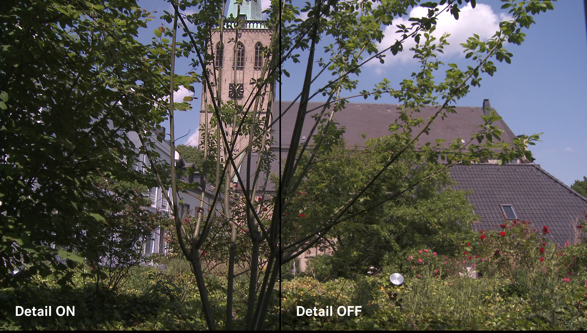

Here is a comparison between detail on/off.
regards Dennis

Dennis : a great example, i much prefer the off setting but i can see people thinking there's more resolution in the left. You can also see the effects of sharpening lens aberations too!

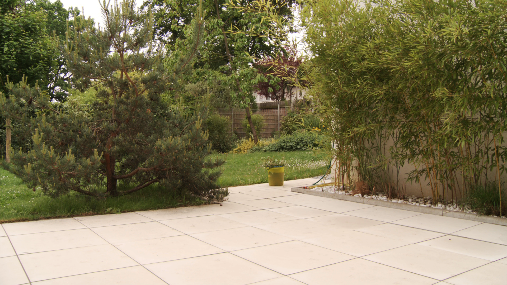

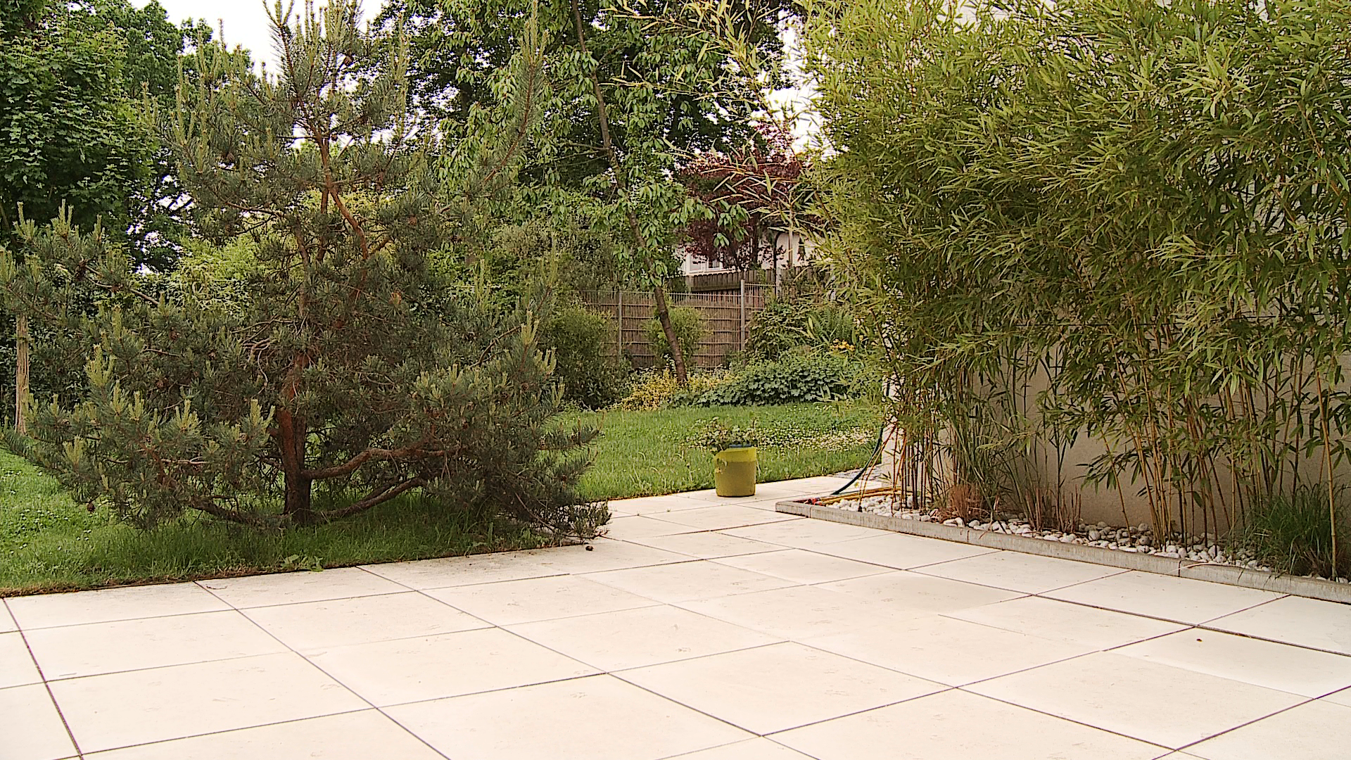

Here are some examples:
http://www.dominik.ws/ex1-detail/1.png
http://www.dominik.ws/ex1-detail/2.png
http://www.dominik.ws/ex1-detail/3.png
http://www.dominik.ws/ex1-detail/4.png
http://www.dominik.ws/ex1-detail/5.png
http://www.dominik.ws/ex1-detail/6.png
http://www.dominik.ws/ex1-detail/7.png
http://www.dominik.ws/ex1-detail/8.png
1: detail off
2: level 0, freq 0, crisp 0
3: level -50, freq 0, crisp 0
4: level +50, freq 0, crisp 0
5: level +50, freq -50, crip 0
6: level +50, freq +50, crisp 0
7: level +50, freq 0, crisp -100
8: level +50, freq 0, crisp +100
all with cine3, gamma-level/black/black-gamma 0, matrix off. Used FCPs ProcAmp-VideoLevel at -0.32 for turning super-white to white.
Dominik Seibold is offline   Reply With Quote
1: detail off
The first one looks best.
The second one already looks like a painting
The third one looks like it has gone through a blur filter.
regards Dennis
regards Dennis
Agree completely.
Dominik thank you for posting this comparison, a fantastic way to illustrate the pitfalls of detail on this camera.
Interesting that with everything zero'd it's still quite bad, yet set to -50 it's blurry. Where's the 'off' setting then (if there is one)
