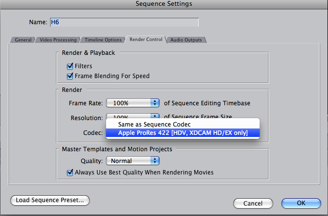

In FCP set your sequence to render in Apple Pro Res and it's very fast. You don't need to do a convert at all. It'll do all renders in Pro Res though so there's no GOP re-conform. You can do that with HDV too. In fact this feature ONLY works with HDV and XDCAM and was recently added with FCP 6.

FCP XDCAM HD/EX & HDV settings to render Pro Res to avoid GOP re-conform

GOP structure actually places more demands on the CPU then I frame files that are larger. It's the same reason DVCPro HD at 100mbps can be less demanding than GOP 35mbps. True the file size is larger with ProRes but the CPU demand is less since I Frame is easier for CPU to handle. Making the renders Pro Res is a good compromise over having to convert the entire file to ProRes (or other I frame format) or dealing with GOP conform on every effect and title.
MacBookPro should be able to handle this too as long as one obeys the rule, NEVER use your system drive (boot drive holding OS and FCP) for media files.
