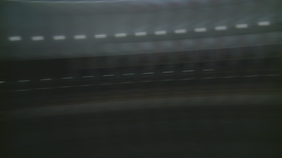

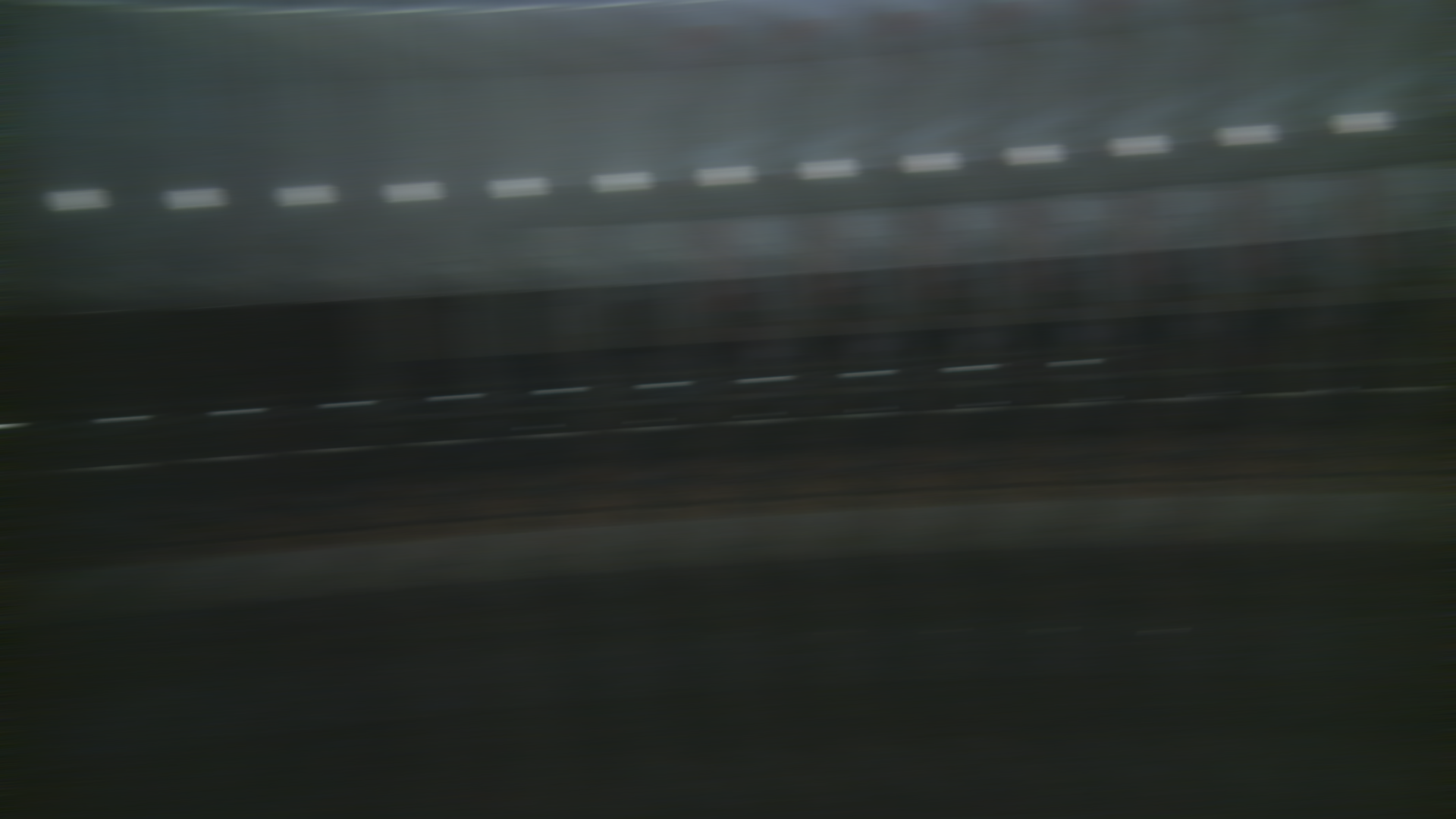

Not wishing to add more noise to this already weighty thread, I simply want to suggest the following 'acid' test...
Dominik Seibold posted a few grabs and merged frames a few days ago which were taken from his EX1 on a spinning chair.
My idea is for a similar repeateable test, but instead place a mirror on the chair (or even better a turntable) with a distant point source light - now you can point two or more different cameras at the mirror and hit record to see how motion is rendered by the different hardware as the reflected light source passes across the frame.
I was a little confused why Dominik chose a shutter angle of 11.25° in his test (=1/768 shutter speed !?) but accept that that was his choice for whatever reason.
I have faked a 'normal' 180° motion blur (added crudely in photoshop) on his merged frames and would expect a very similar result to this from any progressive camera...
Anyone have the inclination (and access to a variety of cameras) to do this would help to settle this issue/thread pretty quickly IMO.
Just my 2p ;)
Cheers,
Dave.
Strobing / flicker effect when panning in 24p-24p-test-180deg-faked.png
