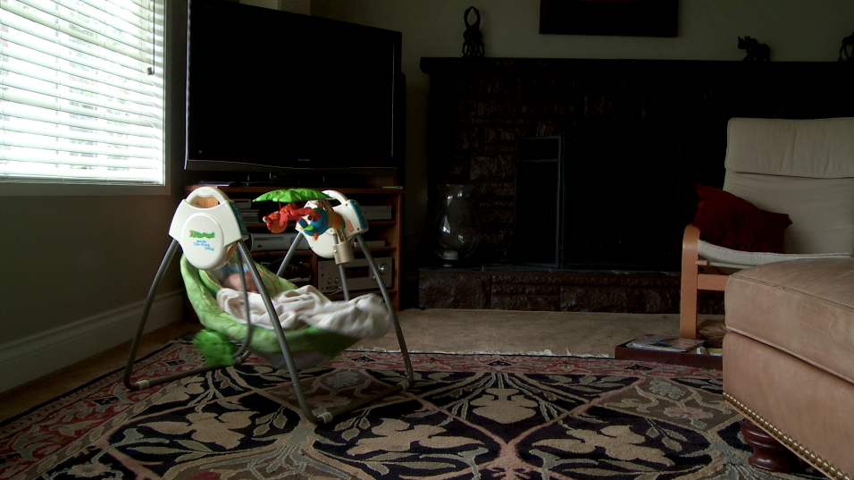

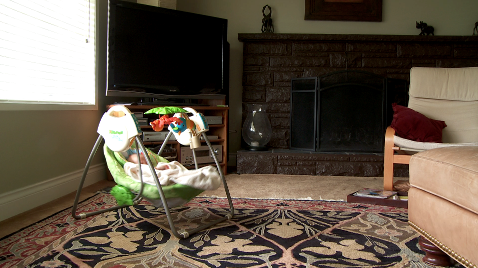

Old June 18th, 2008, 12:32 PM   #15
Location: Vancouver, Canada
Posts: 173
After reading this article, I picked one up today. And I couldn't be any happier with the results!
It nice to have it help with exposure, but white balance is the thing I'm fighting all the time with this camera. And to have something like this and not have to worry about setting up a card all the time, it's great! I will probably start using this on all my shoots!
In the pictures I've posted, #1 is with auto white balance and auto exposure. In #2 I've set the WB & the exposure with the expodisc.
