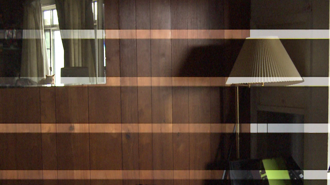

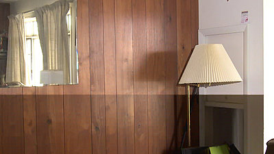

Just did a few tests in the living room
720 p 60 Shutter on at 1/2000
1080i
shutter off
Essentially 60 p picked it up for about 4 frames and interlaced for 2-3 frames. All of the other frames are not as bad.
A flash in any video is distracting. With the EX1 it is distractingly different.
When It gets dark I will do Sparklers and Ground Flowers.

Old July 2nd, 2008, 03:24 PM   #17
Join Date: Nov 2007
Location: Heeney colorado
Posts: 103
oops forgot
Sony PMW-EX1 + Photographer's Flash = Disaster??-2ks3.jpg   Sony PMW-EX1 + Photographer's Flash = Disaster??-1080i3.jpg
