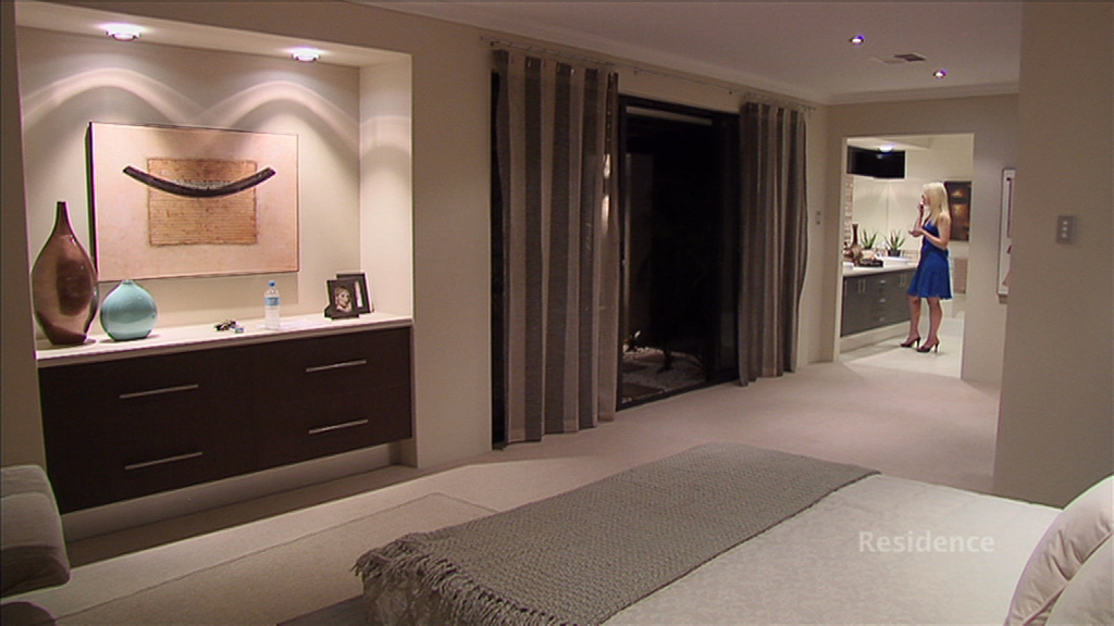

I think I understand what you are saying. I have attached a grab of a clip I produced recently with the 13x3.5 Fujinon wide angle on my JVC GYHD111. What are your thoughts and is there any way i can compare the width the EX1 lens would give me?
I am having trouble uploading the frame. Is there something I am doing wrong? I press upload and nothing happens.

Here is the grab. I finally got it done.

Originally Posted by Matt Daviss View Post
you could budget for a Letus Extreme, rods, box, and a very nice 35mm wide angle (17 or 21mm?) - whilst not exactly cheap, and far more fiddly/time consuming to shoot with than a standard lens, it might add production value all round.
I think for real estate video a Letus or other 35mm adapter would not be so great. Its a good way to get wide angle, but you probably want deep focus for this type of video, and you'll likely not have enough light to stop down the 35mm lens enough.
Dennis, that grab looked nice with not too much barrel distortion.

Thanks for your reply. The JVC has nowhere near the low light advantage of the EX1 but this wide angle lens helps enormously. I have just received a contract to shoot a lot of real estate videos and want to get the job done as best as I can without spending a fortune. This is a grab from down converted footage in the timeline of FCP, from HDV to SD. My dilemma is whether to invest in the Fujinon WA lens for $7000 or buy the EX1. I really dont like the small cam form of the Sony but there is more than enough money in the work I have lined up to just use the Sony for this job. i find it difficult to turn up for a shoot with the small camera. My JVC looks much more Pro with matte box and battery pack etc. Clients really wont be seeing the EX1 with this project so it wont matter so much.
Looking at the grab, I could say your real issue may be the cost. The cost of Fujinon lens alone can buy you the whole EX1, which, on top of this, should be easier to handle for interior shooting because of its low light capability and size. On the other hand, the grab shows the Fujinon just blows the EX1's lens away, distortion-wise. The EX1+0.8 WA = 4.64 mm at the wide end while the Fujinon goes significantly wider at 3.5 mm.
It's a hard choice but as you already own the JVC, getting the Fujinon is probably a good investment. For your type of shoots, the main subject is geometric and straight lines. They shouldn't be rendered blurred or distorted.
Due to the larger chips in the EX, 4.62 mm will give almost the same angle of view as 3.5 mm on the JVC - about 73 degrees.
