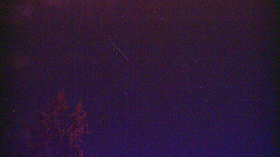

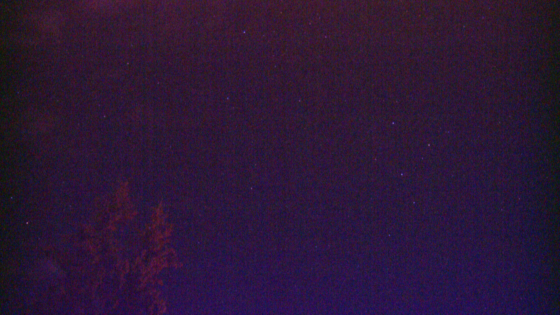

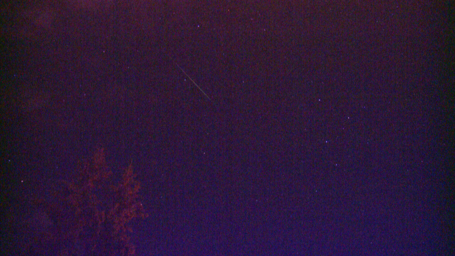

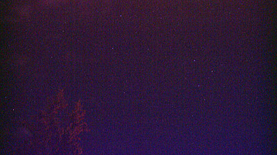

as it turns out, In 64 EX slow shutter every 64 pictures (@60i 1080) are the same. The noise is not acceptable, it needs noise reduction.
Did get a meteor though.
