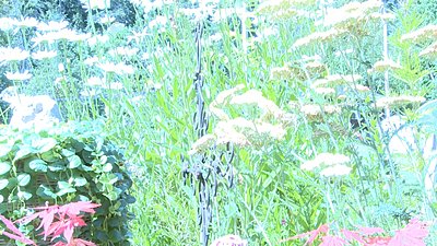

Hi everyone, I bought my EX1 more than a month ago but haven't found time to use it. This past weekend I finally turned it on and shot some footage in someone's backyard, some flowers and a small creek, nature stuff. I imported into FCP and was horrified by the picture quality. Images that in the LCD screen at the time looked great were really blasted and washed out while viewing in FCP. Yellow flowers were blown out to white and sun highlights in the moving creek water were really washed out.
I'm just using factory settings, having just turned it on. I've read factory settings are terrible and I'm trying to figure out the Picture Profile thing. I'm shooting a free little documentary for someone this week and thought I would be good to go out of the box. That's not so it seems.
I can get into the heavier details of shooting modes in the coming months, I'm sure I'll post lots more. But can someone give me a quick crash course on settings I can use to cover the basics. As I'm still trying to learn the camera, it would be easier for me to leave most functions in auto for now, at least until after this first shoot. I'll have both outdoor and indoor filming.
1) Factory setting shooting mode was HD 1080i. If I'm going to make eventual sd DVD's and web clips should I keep this mode? I want the best picture quality to start with and can down convert later. I've read there's tricks with that too.
2) Any thoughts on why my initial shots look so washed out? What I was filming was nice and crisp with lots of color. I'll try to attach an image of what the footage looked like.

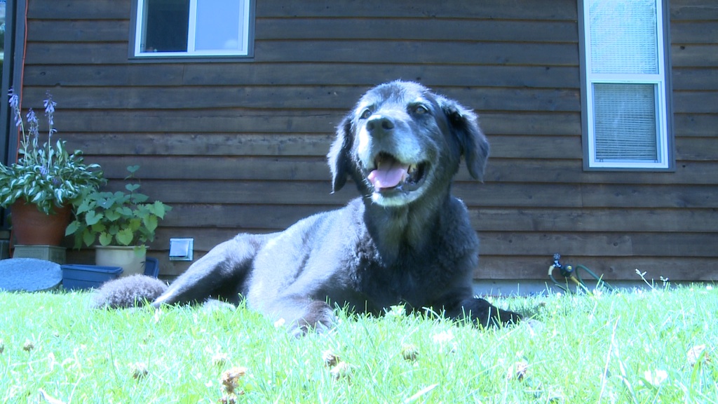

Here's another image. See how the grass is so washed out? It was nice and green in person.

First, I would make sure you are white balanced. Looks like you are shooting in daylight with tungsten settings.
Second, it looks like you are overexposed - learn to use the histogram or the center spot reading on the camera. And try shooting in manual mode if you are not already. You'll have much better results. Try one of the cine gamma curves as well.
Also, for outdoor shooting, you'll probably have to use one of the ND filters even in full auto.
There is much else to consider, but these are starting points.
Does the image look much different on the computer from what it looks like in the LCD? If so, something else may be going on.

Well, as you realise, the shots are over exposed. Factory settings are not awful and will deliver fine images, but custom settings will do better once you understand what you're doing. There is a lot of information in the "stickies" to help there. You can't judge exposure (at least not well) by the look of the LCD screen and you will need to switch on the histogram display and at least one zebra, these being primary guides for avoiding clipping. You have to manually switch the ND filters, so observe the display indications. I don't know how reliable the auto functions are, but I've seen here criticisms of auto focus. You will want to fix shutter opening/speed anyway and you will want to set gain level to -3dB/0dB and not more than 6dB if light permits. WB is better set manually. You will have to be precise with focusing and displaying the DOF indicator is helpful. Preferably do not use apertures smaller than f/8 (e.g. f/11, f/16) and f/5.6 is a better limit (to avoid diffraction blurring). I wouldn't say this is a camera that can be used well without familiarisation.

I got the same washed out images the first time I shot also. Turned out that what I was seeing on the LCD screen wasn't the same as what was being shot. So I plugged the SDI out to my calibrated HD monitor with a long cord and ran my EX3 outside and set it up. Did some tweaking with the Brighness and Contrast settings to get my LCD to match the HD monitor. Then spend some time working on the PP's. Once I got the LCD screen settings correct my recorded images are spot on.
Rick Jones is offline   Reply With Quote

Screen brighness too dark, same here.
I got mine better by switching on auto iris, which will make the screen seem dark then up'd the screen brightness in the menu, (not back light brightness)so that what i see on the screen looks the same as what i see when i look at the scene (not camera screen).
Now my shots look correctly exposed.

The samples are definitely over exposed.
Don't use the LCD to judge exposure. Only the eyepiece can even come close in outdoor conditions. I rarely use the LCD and rely exclusively on the eyepiece to judge exposure and focus.
The EX1 provides very good exposure info via the two zebra settings and the histogram.
I set up zebras at 80% to warn against potential over exposure, and 100% to provide definite warning.
Anything from white walls to normal clouds shouldn't be much over 80% in an outdoor scene. The only thing hitting 100% should be the sun and sparkling highlights such as chrome or other hard sun reflections.
If you keep the histogram centered, you can be assured you'll get details in the highlights and shadows.
