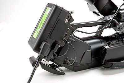

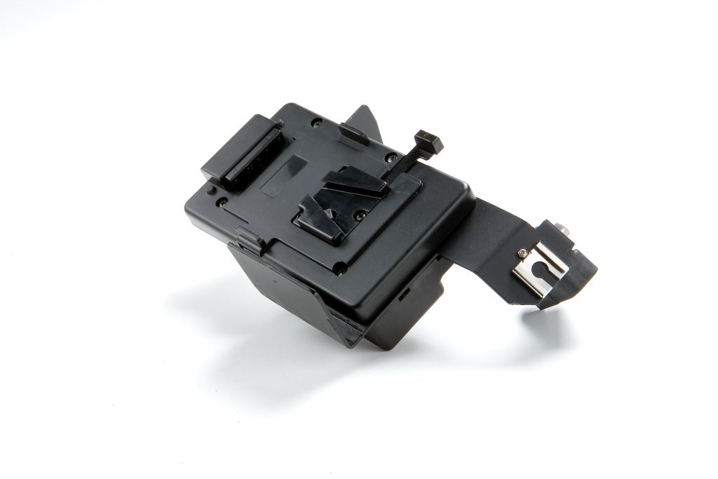

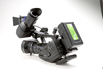

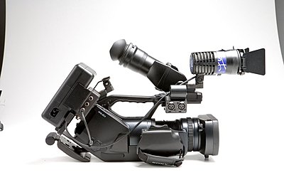

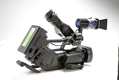

I thought that I should share a bit of very interesting info with all of you.
Bebob will be launching a new product for EX3 at IBC - Coco EX3- it's not yet on the site but I've been told that it should be put up on 11th September. I had the privilige to get to know as I had initially bought the Coco-EX and queried whether they are willing to do something better for the EX3.
In fact this new accessory will enable us to use the proper V-lock batteries and I was told
that it has 2 D-taps plus 4 Hirose. According to my source, they "...went for an Hirsoe for the camera to give the possibility to the customers to exchange the cable easily, should it be damaged."
This is not an advertisement (and I do not work or receive any commissions from Bebob) even though it might read as one. However I think that this accessory is fantastic. One V-lock battery of about 140 WHr should give enough power for both camera and an onboard 20 watt light. The added weight of the battery would hopefully counterbalance better the camera.

Originally Posted by Brian Cassar View Post
In fact this new accessory will enable us to use the proper V-lock batteries and I was told that it has 2 D-taps plus 4 Hirose. According to my source, they "...went for an Hirsoe for the camera to give the possibility to the customers to exchange the cable easily, should it be damaged."
My only concern would be that the centre of gravity looks like it is creeping higher, which makes the job of a fluid head more difficult and impacts on its load-bearing capacity. In my experience this also affects one's ability to make/balance smooth movements too as the leverage/turning effect is increased. Also, while they have sought to add another cold (?) shoe in place of the one the device covers, it doesn't seem to offer enough clearance to be able to mount anything useful there aside from, say, a wireless mic receiver. Maybe. Something like the Protech ST-7 makes more sense to me ( http://www.protechweb.jp/products/st7/st7/index.html ).
http://www.protechweb.jp/products/st...age_st7_01.jpg
I like the fact that we may start to see these devices now. I would prefer to keep my Sony batteries as spares/backup and use my IDX system for the camera itself. Let's hope we will soon see alternative arrangements from other manufacturers - or, ideally, a simple adapter and break-out box/panel which fits the socket and runs to the battery on a separate plate (for those of us who have rail systems which accommodate V lock batteries already).

I contacted bebob after building my mount - I really loathe the thought of going into manufacturing! They already had this product underway and I've been awaiting it's release.
This part is actually the Coco-EX3-V - and yes, there will be an Anton-Bauer version available as well. Listprice is 295,00 € - and they are saying the US streetprice will be around $450 US.
This adapter is displayed with the Omega V140C battery - cool product that I've not seen before - don't have to pack chargers - very nice!
Anyway, it looks pretty nice - and will help with balance. A shoulder-mount will really complete that task, though.

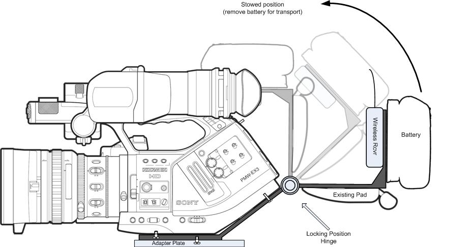

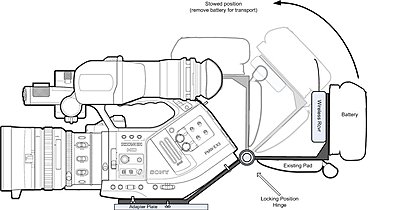

Personally, I'd like a mount that would fold for storage or extend for use - both for shoulder and for tripod - with better balance. Also, I'd like to utilized multiple mounting points in order to fix the mounting plate more securely. I think I'm going to build something like this...
(I'm still shopping for the right hinge design - the ones I drew are great - selectible in 10 degree increments and very strong. However, they are pretty pricey. Also, I'll add a pad to the part of the mount that meets your upper chest.)
