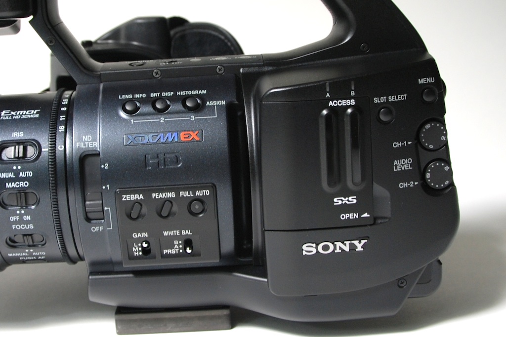

1) What is the tall, deep body gap that sits in front of the SxS slots? (see attached photo) Does this serve a purpose other than being a hide-out for dust? Will dust in there become a problem for any camera function? Is using compressed air cans to blow this area out a bad idea?

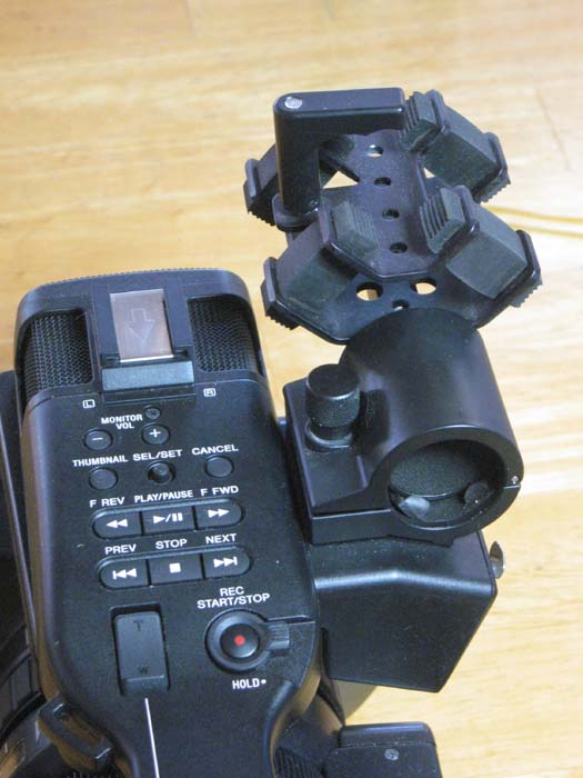

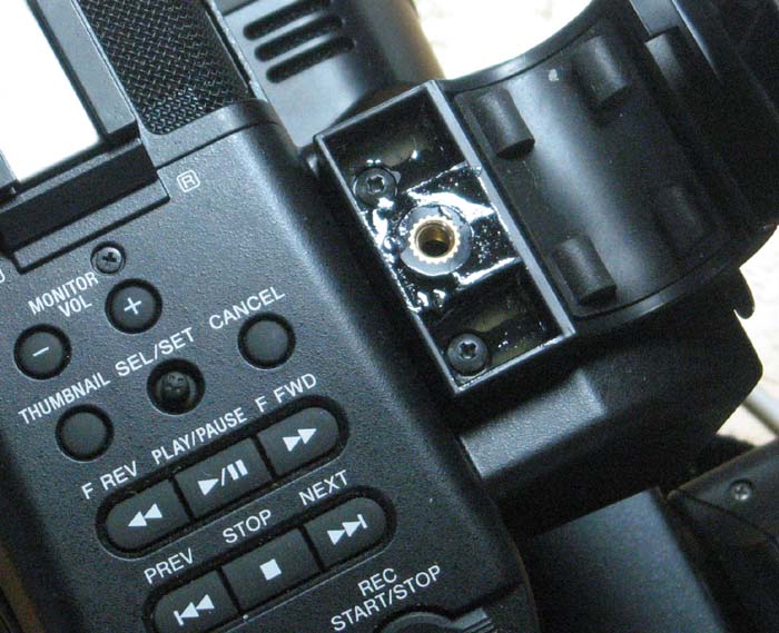

2) The shotgun mic holder seems very loose and doesn't hold the Sennheiser I have very well. Even with the holder screwed
down tightly, the mic is floppy and can easily bang against the hard plastic of the holder. Does anyone else find this? Are there any
particular fixes to this, like adding some padding?

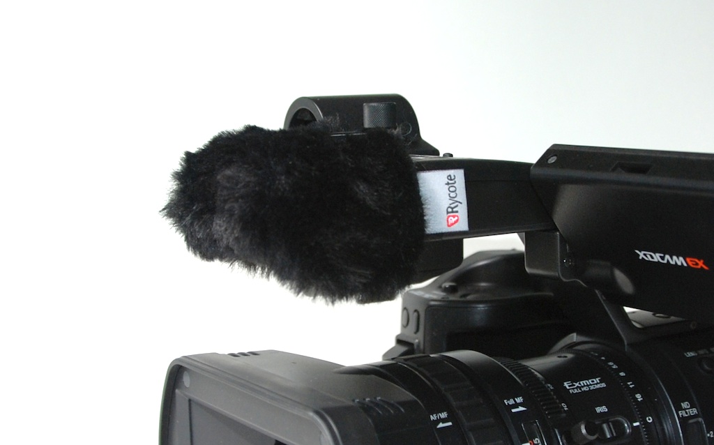

3) I bought a mini wind jammer made for the EX1 mic from B&H. (see attached photo) Anyone else tried this or something similar? I also noticed in the audio menu of the EX1 that there is a "wind filter" option to turn on and off. How does this affect the audio, does it work, or is it a gimmick feature and best left turned off?

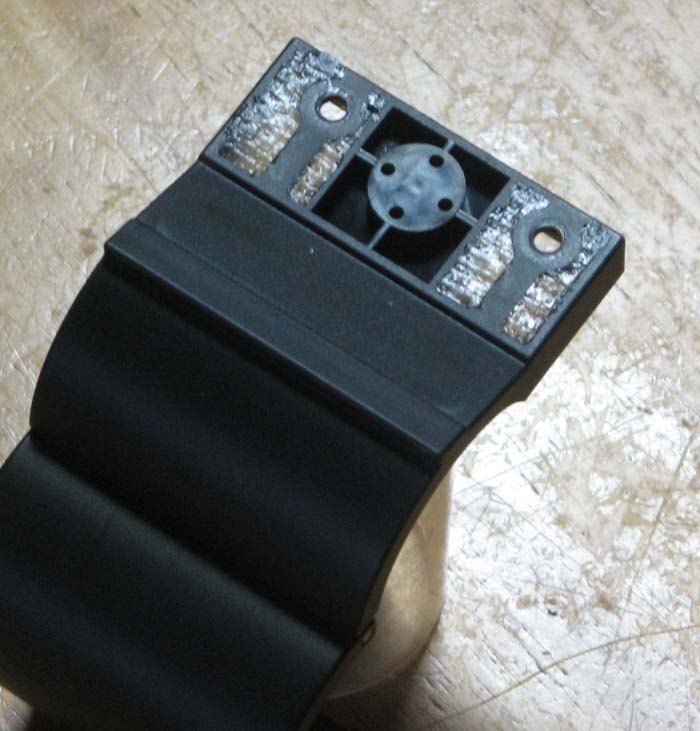

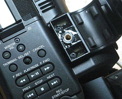

The "bumps" in the rubber mic holder are actually hollow and very soft. On my own camera a Lightwave mic mount sits in there, and the Lightwave mic mount holds onto the mic.
The mic mount is very fragile. It could be the thin strips of plastic connecting the screws to the mount itself have already fractured, thus the flexibility of the mount.
I beefed mine up with fiber-reinforced epoxy. The spaces between the strips and other voids were carefully filled in after the interior surfaces were roughened with a tiny Dremel bit.

Here's a shot of the Lightwave mic mount. It's actually the one for the Canon XL1 but the cylindrical base of the mount just happens to fit the mic clamp of the EX1.

I used the built in wind filter and have to say it was pretty amazing on how well it actually works... I leave it on at all times... It is just a filter not an eliminator just to be clear but you will notice a huge difference between off and on. I have used some compressed air to blow some dust out of that area several times with no drawbacks that I can see... It's purpose is to allow heat to leave the camera...as far as I know.

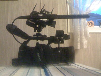

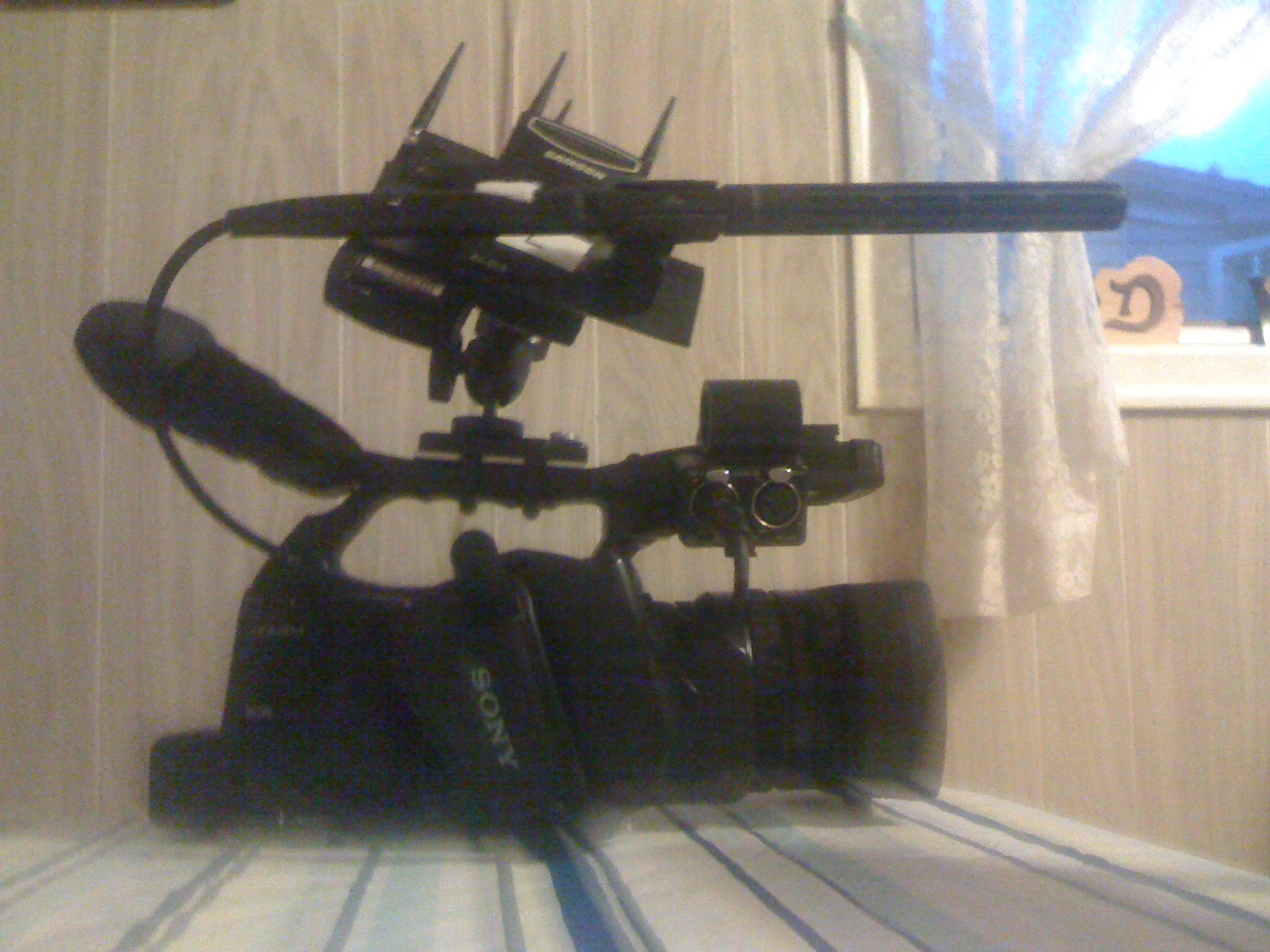

Mic Mount
This mount I made up works for me.
Unless I'm mistaken, it's for cooling purposes. It runs through to the other side of the body. I have no idea about compressed air, but since its purpose is to dissipate heat through air circulation, I'd venture saying a puff or two will do it no harm. Just make sure the air can is upright when blowing otherwise very cold liquid air will come out instead and THAT can't be good for the camera.
Nick Csakany is offline   Reply With Quote
Yes and it doubles as a speaker too i believe.
No, the speaker is on the front side of the rear handle post. Although I've seen similar-looking bass-reflex speaker ports.

That slot is for upgrades and accessories -- you slide your credit card through it and the payment goes directly to Sony's bank account in Switzerland.

Ray and Dean,
I have a good shock mount myself so I'll try to rig something up along the lines of your custom set ups. Thanks.
