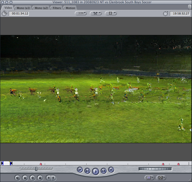

I'm importing a clip into Final Cut Pro whose size is greater than 8GB once it is stitched together by XDCAM Transfer. Once the clip is imported into QuickTime format for FCP, there is a fairly serious 1 second audio and video glitch within the first 5 minutes of the imported .mov file. I can reproduce this 100% of the time and was wondering if anyone else had noticed the same problem?

Usually within the first five minutes of video, you will see a 1-second glitch in the video that looks like a bad MPEG stream... like when you have a scratched DVD and the video gets pixelated. This is usually but not always accompanied with a high-pitched sine wave or screeching tone that lasts for about 1 second.

Note: I attached a screenshot of what the glitch can look like. This is supposed to be a soccer game, but it is rather unrecognizable. This is the glitch at its worst. Sometimes it's not this pronounced.
XDCAM Transfer 2.7.1 Bug/Glitch when Importing Clips Larger than 8GB-picture-12.png
