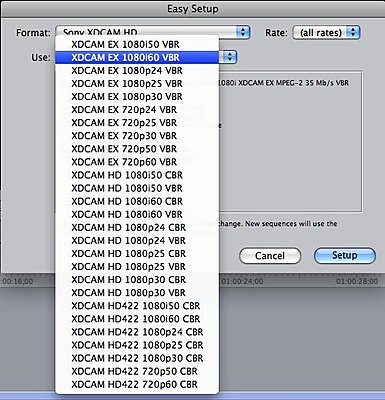

I'd say that initial installation of FCP Studio 2.0 was incomplete. All the options (Easy Set-Up, Import & Export) have been present on my system since day one and they are updated accordingly to 6.0.5.

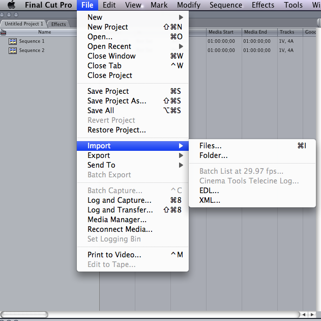

OK forehead dented from pounding against desk top...
I can see the EX3 in this mac's finder window.
FCP is version 6.0.5
I've got XDCAM EX 1080i50 VBR through XDCAM HD422 720p60 CBR sequence presets
I installed XDCAM EX clip browser (functions fine on it's own)
I ran an easy setup for the Sony XDCAM HD
I go to File/import/ - I see only the attached image. No EX3 footage. What am I missing? besides a screw..
Eric Gulbransen is offline   Reply With Quote
Old December 8th, 2008, 07:36 PM   #7
Location: Palo Alto, California
Posts: 520
Never mind, I figured it out. Old version of transfer program. Downloaded the new version and we're in business. Of course now I can see that the footage is overexposed, so we're out of business again, but at least now I can see the files..
