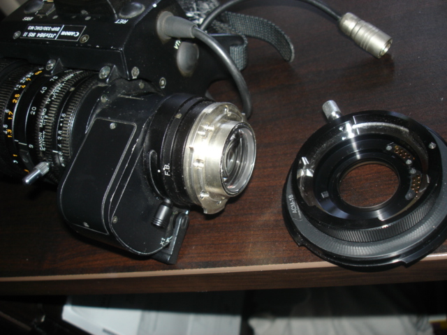

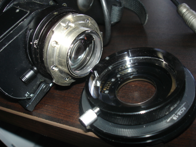

Old December 10th, 2008, 08:09 PM   #5
Location: australia
Posts: 407
Thanks bob,
i am not worried about the electronics of the camera, just wanting to mount it.
I have (SONY EX3 adaptor and the lens) the lens is to 1/2'' and the adaptor is for 2/3'' so can i get a adaptor to go in-between the to.

Old December 11th, 2008, 02:51 PM   #6
Location: Albuquerque, New Mexico
Posts: 292
The one you found by Sony will let you attach the lens, but you will not have any auto controls over the lens or record function. No information in the viewfinder about the lens settings.
