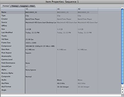

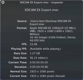

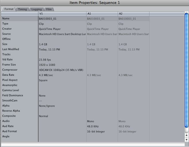

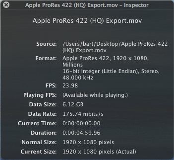

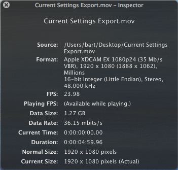

Well you perked my interest, so I tried this and posted my results below to ensure that we are on the same page. I used the QuickTime Inspector window to determine the frame sizes. They are all the same full/current frame size of 1920x1080. Do you get the same results when comparing to my clips & various exports?

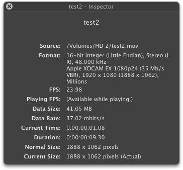

Here's how mine looks after I export it with QuickTime conversion

It's an archaic thing called "clean aperture". You just have to turn it off in the movie-properties of your clip in the quicktime-player to see the whole frame.

That did the trick... thanks for the help guys!
