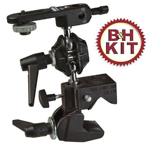

Bogen / Manfrotto | 155 Double Ball Joint Head with 2933 Camera
http://www.dvinfo.net/conf/attachmen...1&d=1229622042
Just clamp it onto a C-stand or something firm.
