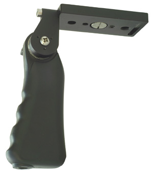

This works great for run and gun. From Cavision.
Jason Davenport is offline   Reply With Quote
