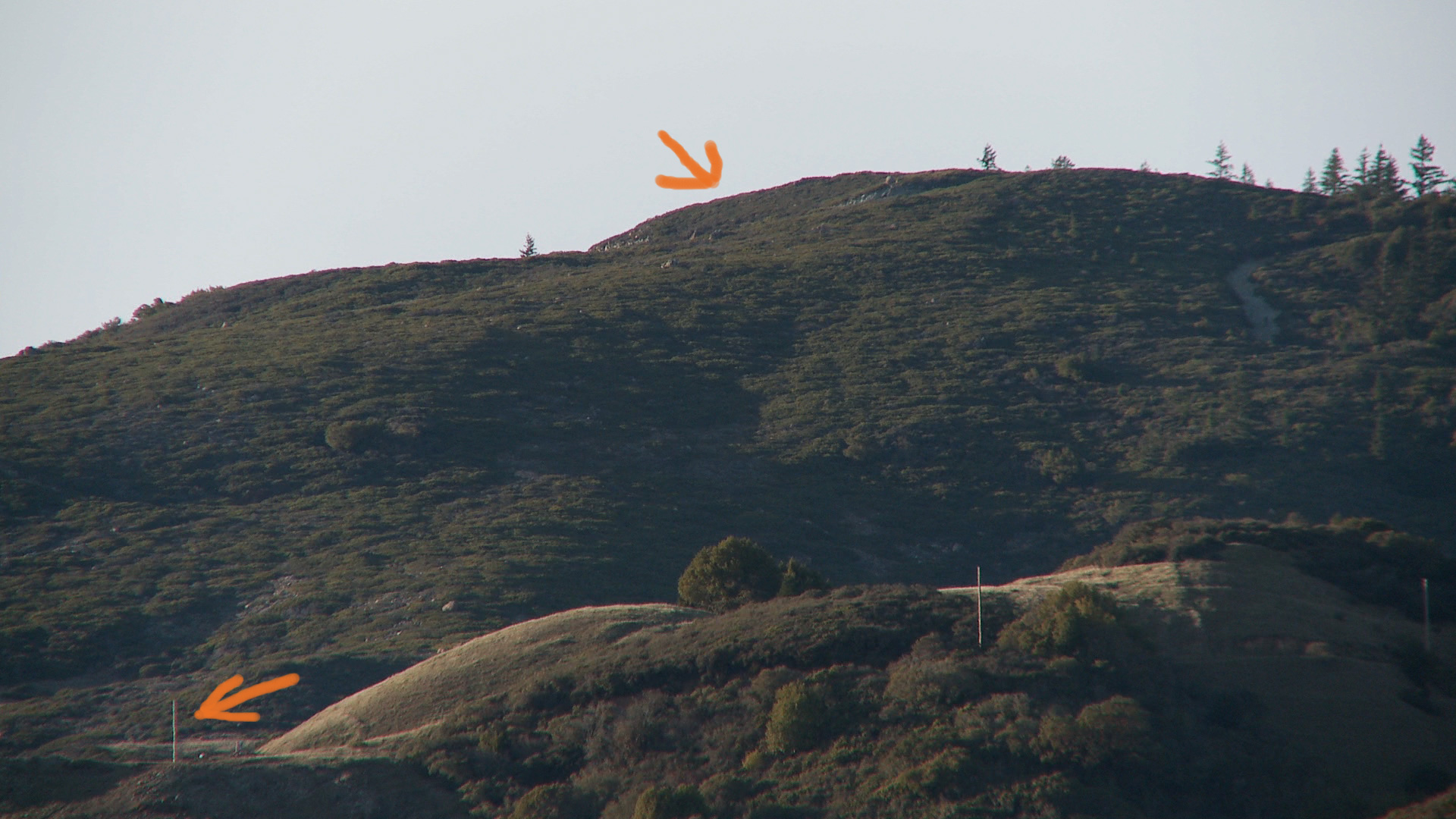

I just experienced something similar. I was shooting scenics and most all footage was OK except for one where I was 90 degrees from sun, fully zoomed in, at @ 4F stop.
Notice the red line on horizon and telephone poll.
I just sold my Canon XL-H1 and never had this issue. Is this normal for EX1? What is the fix?
Kevin, I think it is exactly the same issue, if you look closely there is a cyan line at the opposite side of the red or magenta one on both telephone poles far left and right.

Don't think a filter will help but you can get rid of it pretty well in post. Just pick that colour and de-saturate it (or something like that, I know I've seen my editors do it!)
