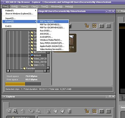

Graeme, that's why I was confused about Peter's post. ClipBrowser has export to MXF for NLEs. Peter did not say what "trouble" he found so I was thinking maybe that didn't work. I could have given him a more complete answer with screenshot 6 hours ago if he mentioned what the trouble was.

Sorry for not being more specific Craig. I tried to do it using the conversion to Avid V5 in Clip Browser but when I attempted to input these to Avid it didn't recognize the CODEC. I have since followed your advice Graeme using the mxf file conversion and can now input. I am only setting up Avid for the first time so am a complete beginner with it. Using this route will I preserve the HD quality? So far I haven't found any sound or maybe it isn't turned on in Avid as yet. Any suggestions would be gratefully received.

I'm using windows XP. When I export from Clip browser using mxf for nles I do not get sound. I do not know what the size of the image is. When I use the mxf XDCAM HD 25 Mbps option I do get sound but lose the full 1920 pixel width and get 1440 x 1080 at 25p. When I use the mxf XDCAM HD422 option which supposedly gives the full 1920 width, I cannot transfer and get the message "File cannot be imported Format or compression is not supported"
