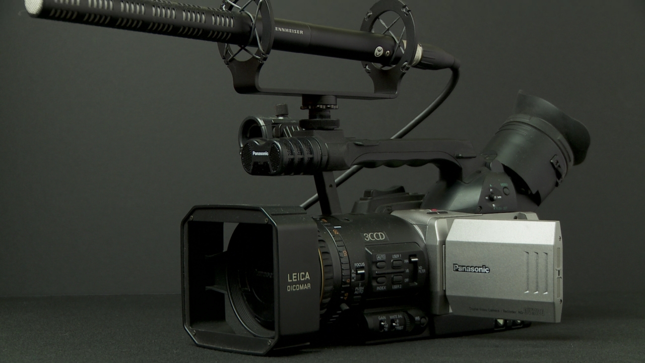

Old January 25th, 2009, 05:39 PM   #24
Location: Tallahassee, FL
Posts: 4,100
Done.
I don't have one with the mic on he EX1, but here is my shockmount on my DVX (pardon the dust!)
** Note the empty mic holder on the DXV. Also note that the bands are set up wrong on the shockmount so don't do what you see here. I hadnt used the thing in ages and set it up in a hurry.
Originally Posted by Bob Kerner View Post
I'd appreciate pix of your camera-mounted shock mounts if you have them so I can get an idea of what this will look like.
Thank you one and all!
