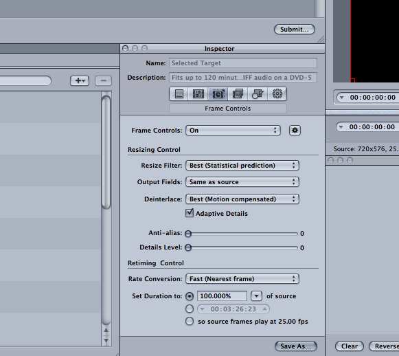

I shoot 720p/50 all day every day, no need to go any bigger, i use FCP, if your footage is going to SD just use compressor and turn on see pic att.
Rob

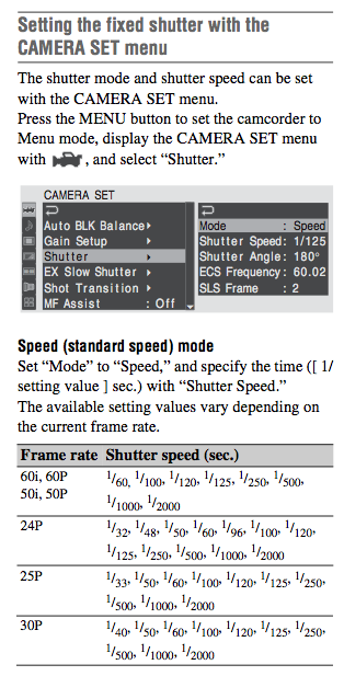

One last question and it's to do with the shutter.
If shooting 1280x720 @ 50p what should my shutter be.
Should I set it for 100 shutter or 60? or 180 deg.
I have tried all shutter settings, found its better to leave it off.

Technically it should be 1/50th (to match the frequency of your power - 50Hz) But you'll loose light sensitivity using a shutter.
I think it's a matter of taste.
If you like the "film look" where you can see each frame (some call it flicker) then use a shutter.
If you're going for the super sharp video look (like you're actually there) then shoot without a shutter.
If you're planning to slow down the speed of your footage, you'll get less "frame blur" when you shoot with a shutter. If this is the case you might want to try even higher settings (1/250 or 1/500)
It's all a matter of taste in my opinion. :)

Shutter should be double the frame rate for progressive and off if in interlaced.
I could be wrong?
Vortex DVD explaines it.

Faster the shutter speed less blur but less light gets through, shouldn't be a problem though, i presume the game will be well lit.

I'd vote for either 1/125 or 1/250 for basketball. But you might not have enough light for that high of a shutter speed. Worst case shoot at 1/50.
