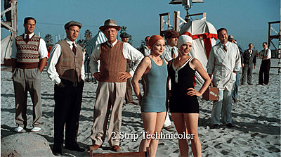

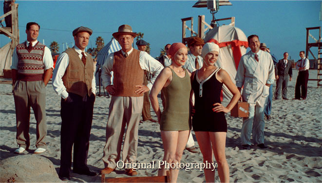

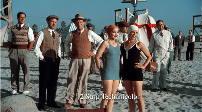

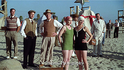

Magic Bullet does 2 and 3 strip verry nice.
Thou you can get dammed close by traditional Color Grading.
I gave it a try - just used selective color corrections.
1. is the original Photographie
2. is my attempt with traditional grading
3. is the Aviator Technicolor
Movies of 1950s: colors pop, how to achieve in EX1?-1.jpg   Movies of 1950s: colors pop, how to achieve in EX1?-untitled-1.jpg
Movies of 1950s: colors pop, how to achieve in EX1?-untitled-2.jpg

I've got Magic Bullet Looks, but I don't remember a preset titled "Aviator Technicolor". Did I misunderstand your post?

Frank, I have MB Looks 1.0 for AE Win XP.
I could only find a Two-strip Cool effect in it. By taking the Cool part out, I do not get the nice two-strip effect you have illustrated in your images.
What version of Looks do you have? Which platform/host?
What are the exact names of the presets?
I really like the two-strip example in your pics...
