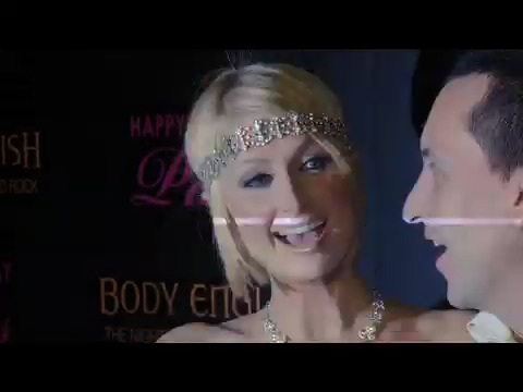

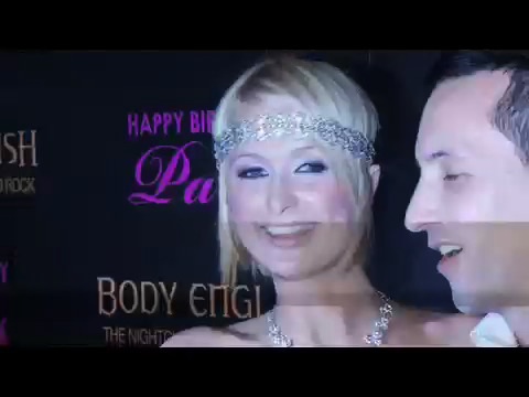

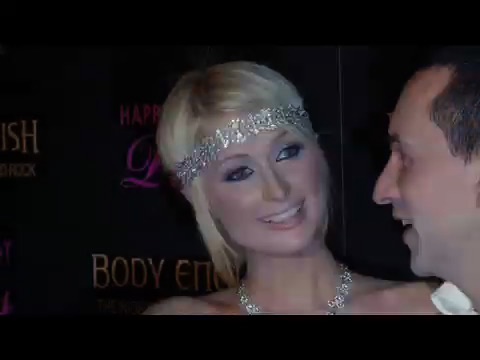

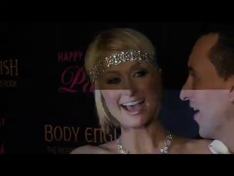

I thought I'd upload the images of the kinds of frames/flashes I saw in your video.
Theres:
Normal
Flash which looks like a normal full flash frame
Bottom Flash which was followed by top flash which is typical in rolling shutter. This is why I'm wondering if dropping the shutter speed might smear them.
Horizontal line flashes of varying brightness/darkness. I haven't seen that before and I suspect that's a result of multiple cameras flashing. It these horizontal banding flashes which look the worst in my opinion.
Rolling Shutter and flash (again, sorry!)-normal.jpg   Rolling Shutter and flash (again, sorry!)-flash.jpg
Rolling Shutter and flash (again, sorry!)-bottomflash.jpg   Rolling Shutter and flash (again, sorry!)-topflash.jpg
Rolling Shutter and flash (again, sorry!)-horizflash.jpg   Rolling Shutter and flash (again, sorry!)-horizflash2.jpg
