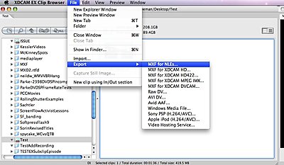

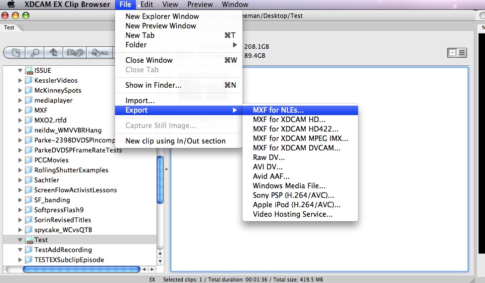

Please respond when people ask for information. Update ClipBrowser to at least 2.0 but ideally 2.5.
There is NOTHING wrong with the way ClipBrowser works with Sandisk as I've been doing it for MONTHS.

Bob, I wish Tito would explain his problem so we could do more than guess. He seems reluctant. Ronn asked about ClipBrowser version and he didn't answer so I guess and mentioned versions and included screenshot.

Tito,
Did you look at my screenshot? Again I'm confused since you don't seem to respond to some of the things people are posting.
Simply make sure you have the folder with the BPAV selected as I do in the screenshot. Select the Clip. File/Export/MXF for NLEs.
Sony does a HORRID job in that they do NOT include the ClipBrowser PDF Manual with 2.0. It can be found if you're a detective though. It is included with 2.5 though. Go to the thread in this forum for ClipBrowser 2.5 software.
