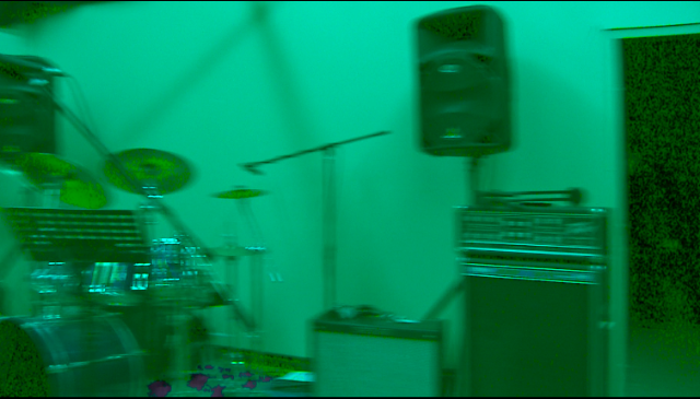

Hi Guys,
I have an EX3 and was doing some testing, all was good UNTIL...
I put the camera into S&Q mode (over/undercrank) and the entire image goes bright green. I can still see some detail of the scene, but even with the Iris closed all the way down I see dancing bright green noise. Even with the gain off, this occurs. Any ideas? I have been throught the entire menu and can't find a setting that affects it. Also, in the menu the option for S&Q mode is grayed out.

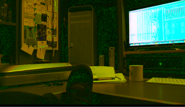

Here's some screenshots of my problem, taking the battery out didn't help.
Huge Issue in Slow and Quick Mode-mail-1.png   Huge Issue in Slow and Quick Mode-mail.png

Not very ontopic, but I had the "same" issue with a 3CCD Sony VX2100. From one moment to the next it looked exactly like on your pics when I switched the cam on.
It was a problem/dying of the green CCD in the cam. The problem was known by Sony and they replaced the complete 3CCD part and prisma for free... If I would see this again on my EX1 I would not hesitae to bring it to service immediatly. Not to loose again important shots.

Sony still has a CCD bulletin on PD170's and will replace them for free. We sent a lot of them for that at the last Rental house I worked at. This is definately an issue with the processing of CCD information, but because it only happens in certain modes, it can't be a CCD. I'm using it next weekend and then it's going in, I'll keep you guys posted in case you ever have this issue.

Cam was messed, part on backorder, still not sure what's being replaced. If this happens to you it's done.
