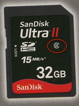

Did the cards say class 4 or class 2? It seems the older class 2 cards work but the "revised" class 4 do not.

I bought these class 2 in January. They work. The red circle is just my highlight to show where the class is on the card and that they were class 2.

Paul, can you confirm that they actually say class 4 on the card face, not class 2? See my screenshot above.
Also given that so many are reporting failures can you point us to where you purchased them?
