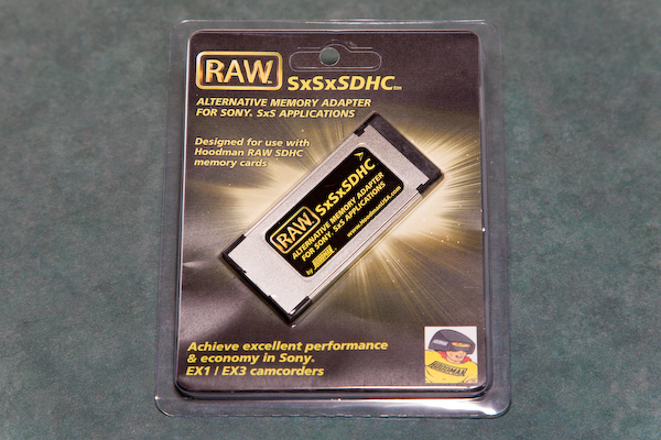

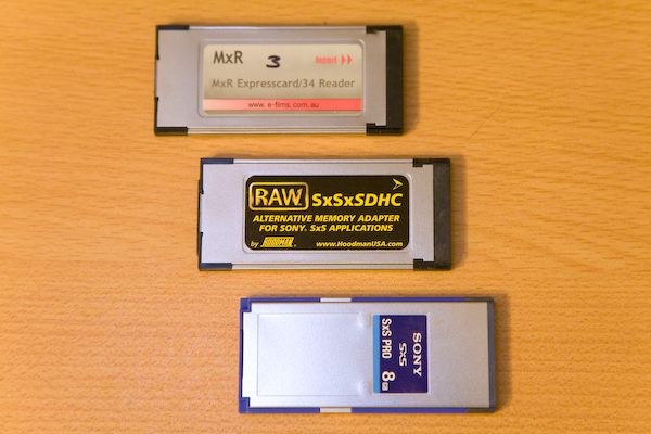

I had the good fortune to spend some time with the new SxS adapter on the market made by the Hoodman corporation and would like to share my experience.
I worked with the expresscard adapter, one 16gb SDHC card and the included SDHC reader.
The packaging was clamshell but easy to open. I did not need a scissors and no injuries were reported.

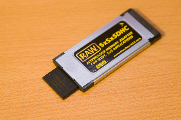

The first thing I did was take the SDHC card and insert it into the SxS adapter. The fit is snug and is easy to take in and out. One thing I like is that for each action (insertion and removal) there is a definite "click" which tells me the card is locked in or being ejected. This is a plus for a system made to work together as it gives a little more confidence that the SDHC card is where it needs to be and will stay in place.
As far as I can tell, this adapter is identical to the MxR adapters I own as shown by the photo. As it needs to fit the SxS standard to use in the camera.

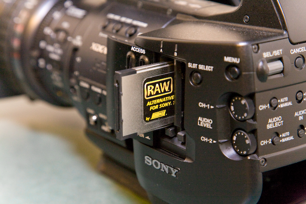

I then inserted the adapter with the SDHC card in the camera. The door closes just like the SxS cards. The card formatted instantly and I was filming. I tried some overcranking and found the company's claims of 48 fps to be close but a little high as I recieved error messages at 43 fps. An overcrank of 42 fps was sustainable.
After turning the camera off then back on from the last "media error" message I set the mode to 1080p30, started recording and let the camera run until the card filled up.
I wanted to push the situation and run into some errors and let the card run out of space to see how the camera reacted and behaved. In every instance I had to turn the camera off and back on to get it responsive. There might be a proper button to hit to move forward but I don't know one at this time. Upon turning the camera back on, the memory was responsive and functioning as usual. I then transferred the BVAP folder to my PC.

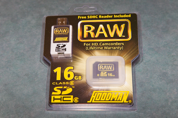

The SDHC card was inserted into the reader and the reader in the USB 2.0 port. I chose to just measure the raw speed of the card/reader and did not use clip browser this instance.
The transfer for the 16gb took 14 minutes so the transfer rate was over a gigabyte a minute. This is pretty nice for a USB reader and beat my other reader by a healthy margin.
So what do I think about the Hoodman SxS adapter?
I think this is a properly functioning unit for the EX-1 and a nice alternative to the price of SxS cards. I would like to see some data on reliability compared to other SDHC memory on the market to support the increased dependability claimed by Hoodman. If they can show the memory is more reliable, then this product is a must have as it is 1/4 of the price of a 16gb SxS card.

I tried some overcranking and found the company's claims of 42 fps to be true.
See product sheet here. Hoodman claims 720p24/48fps.
http://www.dvinfo.net/conf/1070590-post1.html
Base on your report the behavior seems to be exactly the same as MxR, which it should be if it's the same build.
It seems the performances of their SDHC card also doesn't seem any different than Sandisk or Transcend 16GB cards (assuming Sandisk hasn't also made changes in their 16 Ultra II).
