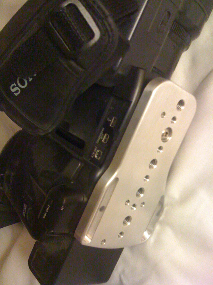

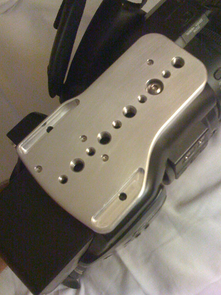

Here is a pic of the first prototype. I am waiting for changes to the mounting hole depths and it should be ready to go...

Joe, I don't have an exact weight yet but the HVX200 is 220 grams, just under 1/2 pound. This plate is smaller than that one. I don't have a scale with grams on it here but I will get the weight when the final plate is made.
Dave, The base plates I make do not replace your tripod mounting plate. They offer more mounting options for your tripod plate to attach to your camera. With my base plates you can use two screws to mount your tripod plate more securely in the 1/4" holes, and people that have a need for the larger 3/8" screw holes now have an option.
Another issue people have had with the EX1 base is the curved body doesn't offer enough of a flat surface and the tripod mount can have some flex. I don't use the EX1 so I don't have any experience with that myself, but that is what I have heard from multiple people. My base plate attaches to the camera with the 1/4" mounting hole and 4 of the smaller screws that go into the base of the camera which then gives you a larger flat surface that will eliminate all or most of the flex.
And the other reason for my base plates is to help protect the base of the camera from cracking. That has been a problem for some people with the Panasonic HVX200 and it costs about $1k to have it fixed. I haven't heard of an EX1 base cracking yet but it is definitely possible. All cameras on this level only have the small metal area around the 1/4" mounting hole and the rest of the base has plastic covering the internal frame of the camera. The plastic can flex and break under stress and allow the metal rectangle your tripod plate is attached to to flex and break the internal frame it's screwed onto. People like me that shoot sports or anything where you need to move around allot could have that problem. Every time I shoot I throw my tripod on my shoulder with the camera mounted to it to hike to different spots. If I bump the camera on something or fall it could easily crack the base without my base plate on there.

you've certainly got me mighty interested. Just to be specific, you say:
Does this mean we remove 4 screws from the base of the camera and use 4 presumably longer screws to attach the plate as well as the standard 1/4" screw?
Bob Grant is offline
Old October 4th, 2009, 05:47 PM   #24
Location: Oceanside, CA
Posts: 46
Exactly, I supply the longer screws and also a new 1/4" screw, and the two allen wrenches you need for them.

Originally Posted by Dave Morrison View Post
Curtis, your plate would attach to the bottom of the EX1 using the screw holes visible in Rob's photo seen here?: http://robcollins.net/640/ex1.jpg
I'm not sure which screw holes you are referring to. The ones on the broken tripod mount? If you look at my two pics of the prototype plate mounted to the camera (post #17) you can see the big 1/4" screw and the 4 small screws that I use. The 4 small screws are ones that are spread out over the base of the camera. If I only used the ones right next to the 1/4" hole the same thing could happen as in that picture, a broken mount. I wish the EX1 base was similar to the Panasonic's because those have 6 screw holes that I use around the edge of the plate.
And thanks for posting a link to that picture. Now I have seen a broken EX1. My base plate will help prevent that from happening.
