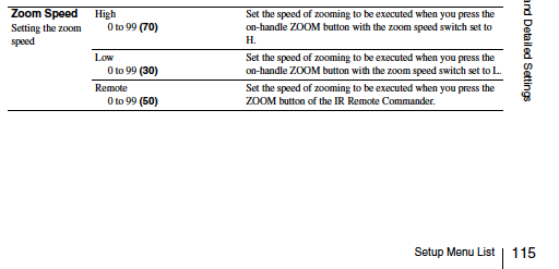

Side Note: I have had my EX3 lens replaced by Sony, original had the fairly common problem with jerky starts and stops. Make sure this is not the problem with your lens, if it is hard to do a smooth slow zoom. Best test is to see it the handle zoom can be set to 1 or 2 and still zoom smoothly, my original was jerky up to 12.
I think I did notice jerky starts, like sticking.
Where is that handle zoom setting, is it in the menu.
Thanks.
Anthony McErlean is offline   Reply With Quote
Old June 15th, 2009, 06:24 AM   #20
Sponsor: Westside AV
Posts: 1,365
Anthony,
In the Camera setup menu for EX3 page 115.
