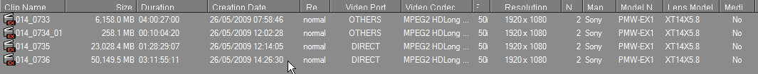

I intended to scrub the 4 hour clip and continue on the same drive, however after switching the camera back on, I found it was offering me 291 minutes of record time.
Assuming some error, I turned off the drive, re connected - same offer - so I put it into record assuming it would crap out after an hour, then went out.
I now have 9 hours of footage on one drive, readable and transfered via Clip Browser, on the timeline all is good - 8 hours and 50 minutes to be exact.
The drive shows a single FAT 32 partition of 78.9 gb - hows this possible? where is the rest of the footage hiding?

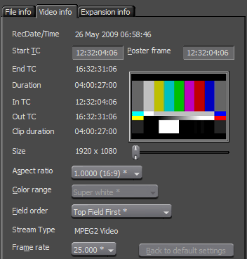

The first 4 hour file is reported as 6gb by Clip Browser, obviously incorrect, and yet it all the duration and code information shows a 4 hour clip.
Edius also reports a 4 hour clip.
Paul

The duration value is correct, 360675 is indeed the 4 hour clip, but the reported file size by Windows explorer, Clip Browser et Al. at 6,158mb, is obviously wrong.
totally strange - I wonder what the EX1/3 uses as its media data source, is it reported as full because of an xml file, maybe we can fool the camera some way ???
