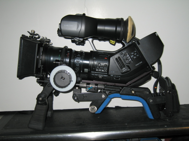

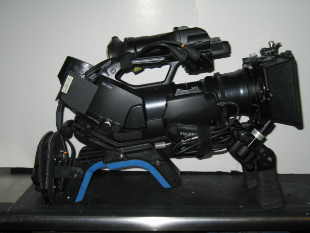

The wheel can be tilted, which may help. I have the CAVISION follow focus and I can get to the iris, no problem. As for hand held, you will want to add some kind of handgrips, the lens holding position is still too close to body. Because, you will be adding weight to the front with a follow focus and matte box, so more front heavy. Plus the VFGadgets adds weight as well. Unless you add 3 pounds or more behind your shoulder, and not sticking out a ridiculous amount, the camera will always be front heavy. You can also clamp a zoom control to handgrips for control. Use carbon fiber rods for weight reduction if possible.
Here is my set up. *Fuji Wide Angle lens on.
EX3, Arri MMB-1 and follow focus-20090616_img_0001.jpg   EX3, Arri MMB-1 and follow focus-20090616_img_0002.jpg

Thank you so much for your reply and photos. I did have some concern about the added weight but I am glad to hear that the follow focus does not impede access to the iris. I will take your advice and look into hand grips.
BTW: I am intrigued by your interesting shoulder mount and support legs. Is it a commercially available setup or of your own design?

All my stuff is from CAVISION, I just added the blue pads with Velcro attachments. Also the VFgadget plate and rod adapter. The boxes that come with wireless box attachment, I didn't like so just made a softbag to hold it.
