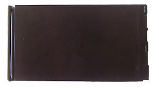

Here's an image of the GripFun PL-U95 battery Bob is referring to...
http://4.bp.blogspot.com/_3RdPHThuWW...320/PL-U95.jpg
As mentioned, it is a lot longer than the Swit but this could be an advantage to some needing to throw weight off the back of the camera for balance and stability.
