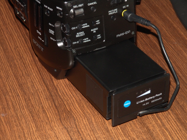

Interesting battery. It's got more juice and it's 20mm longer, 130gm heavier and like the Swit includes a D Tap.
Might be good if running the higher power on camera lights.

Couldn't resist so I bought one :)
I wanted more power to run an on camera light without having to go to a brick battery and this battery seemed like a bargain.
Pros: It comes with a D-Tap lead. A short one terminated in the same plug as used for the EX. Just the D-Tap plug alone down here costs around $35 so it's a worthwhile addition.
Assuming the battery lives up to it's claimed capacity it'll run the EX1 and a light for quite a while. Li-Ion batteries have a high internal resistance so the bigger capacity batteries perform better than the smaller ones.
It might make hand holding the EX1 easier, see photo!
Cons: It's BIG and it's heavier. The weight's barely noticeable but the extra length is very noticeable.
The D-Tap connector ends up on the bottom of the battery in the EX1. Not a huge issue however with the plug in it'll be an issue putting the camera down. I think if you were to leave a release plate on the camera then the plug would clear.
Like all 3rd party batteries the camera only provides voltage indication so it's a bit harder to know how much juice you have left.
After taking the photo I realised the lead can be dressed a bit better by laying it into the groove in the battery, ends up much neater than in the photo. Overall I'm quite happy with this battery. The only other way to get this capacity is quite expensive and between it, the battery that came with the camera and a BP-U60 I can shoot all day off batteries.
