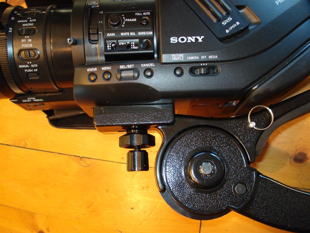

In the never-ending search for a better way to hand-hold the ex3, I tried Phil Bloom's advice and found an el cheapo shoulder brace on ebay. I'd wanted the dm brace, but it's already hard enuf fitting everything into one bag. In the brief time I've had the ec, it looks promising--fits nicely and holds the cam in the right location; pads are hard, but extra foam could solve that.
One problem is that I use a Vinten tripod quick mount plate and want the el cheapo to quick release, as I'm usually going back and forth to the tripod. The ones I've found are fairly expensive.

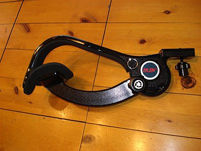

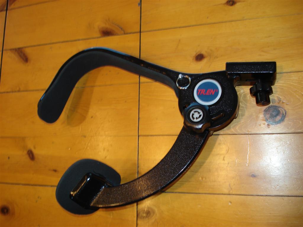

Here are some pix, Rodney--fits nicely, it's just a pain to screw it in each time, plus the wear and tear. Not quite sure what you mean by mounting it to tripod. I've attached the ec to the camera and then want to be able to release it quickly, leaving my Vinten plate (not shown) attached to use on the tripod.

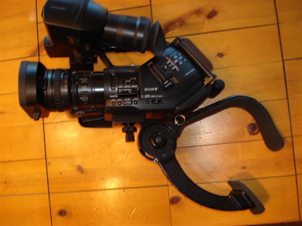

I shot today for five hours at a track and field event with the dm shoulder mount and a $99 tiffen steadistick. No wrist, arm or back fatigue and rock steady. I wouldn't spend a penny more than that on any fancy devices.

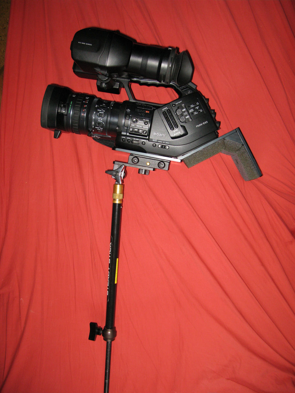

Here's the $99 dollar site for the steadistick. It's a super professionally made piece of equipment which fits easily into the side pocket of any bag and is simple to attach and detach for tripod use. I haven't ever spent that kind of money that well. and no, I don't have any connections to any commercial products. Steady Stick at DVcreators.net

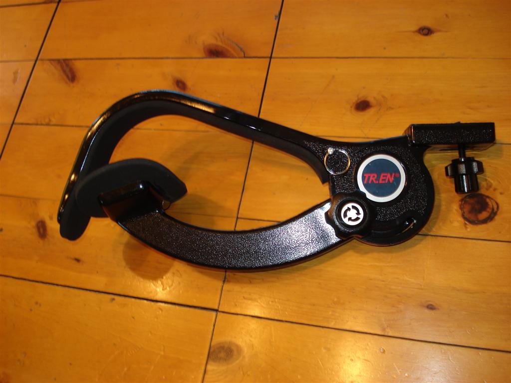

so pleased with it I couldn't resist a picture or two

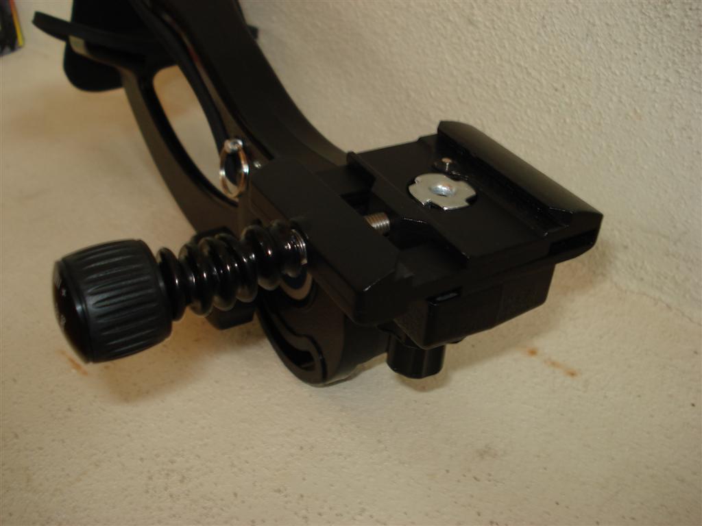

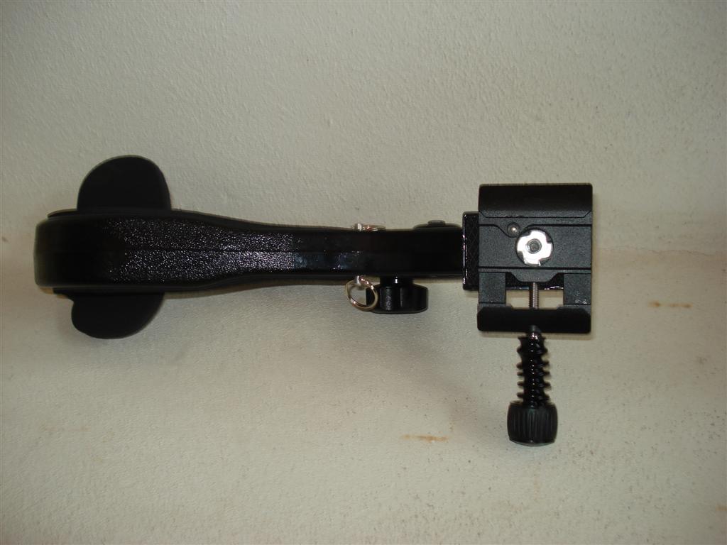

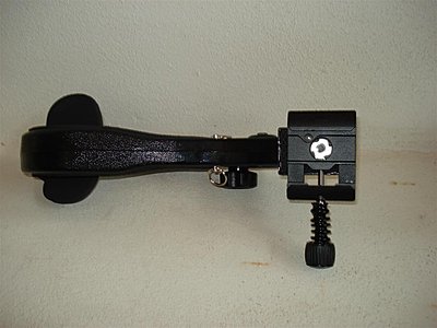

Well, the Gitzo worked. I'm not crazy about the lever sticking out, but it will have to do, as the Manfrotto with its nice flip-lever was 3mm too narrow for the Vinten plate and the Arca was way too narrow. I had to use a flange nut from the hardware store to accommodate the 1/4" screw from the EC, but the fit is very tight. I may loosen it to turn inline for transport, but I can now use the EC with quick release.
