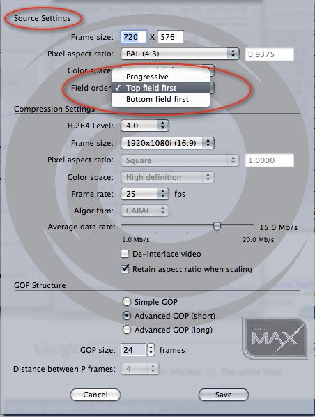

BTW you do know you can set the source to progressive in CompressHD? Perhaps that was also part of the problem.
