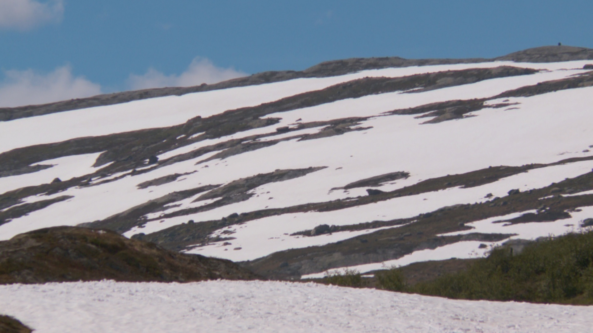

Originally Posted by Darek Sepiolo View Post
Thank you for your opinions.
I've been looking for a plug in for FCP that may correct this problem but havent found anything.
Darek, I use Magic Bullet Looks to do CA correction of the EX1-Teleshots. I brings some relief, see attached pics (Image2.jpg on the right hand side is with CA correction. The shot is a bit blurry due to warm air mixing with cold air above the snow...).
Rgds, Eva

I have the same problem on my macro shots, and I solve the problem this way: If you have a Secondery Colourcorrection in your NLE, you can in most cases isolate the CA colour. Often the CA have a colour that stands off the rest of the picture. Mark the CA with the eyedropper, and finetune the mask. Then back off the saturation or change it to the colour you want with Hue, or other colour adjustments.
Secondery Colourcorrection is a powerful tool.
Hope this helps.

Thank you Eva and Arnt. I've been trying to isolate the CA and adjust it with my 3-way CC in FCP and it helps a bit in fact.
