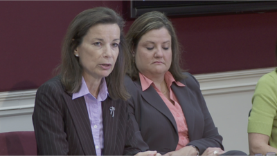

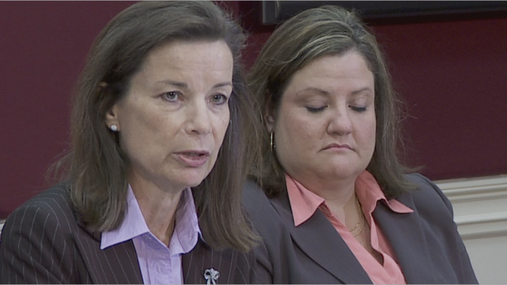

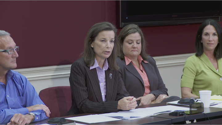

Segments are hard. So how about this..
These shots are one frame apart. The full-frame is EX1 footage on an SD timeline. The 2-shot is pan/scanned in. The closeup is from the same frame as the med. wide. Good enough for web, but I wouldn't broadcast it. Though I've seen worse over air.
