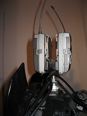

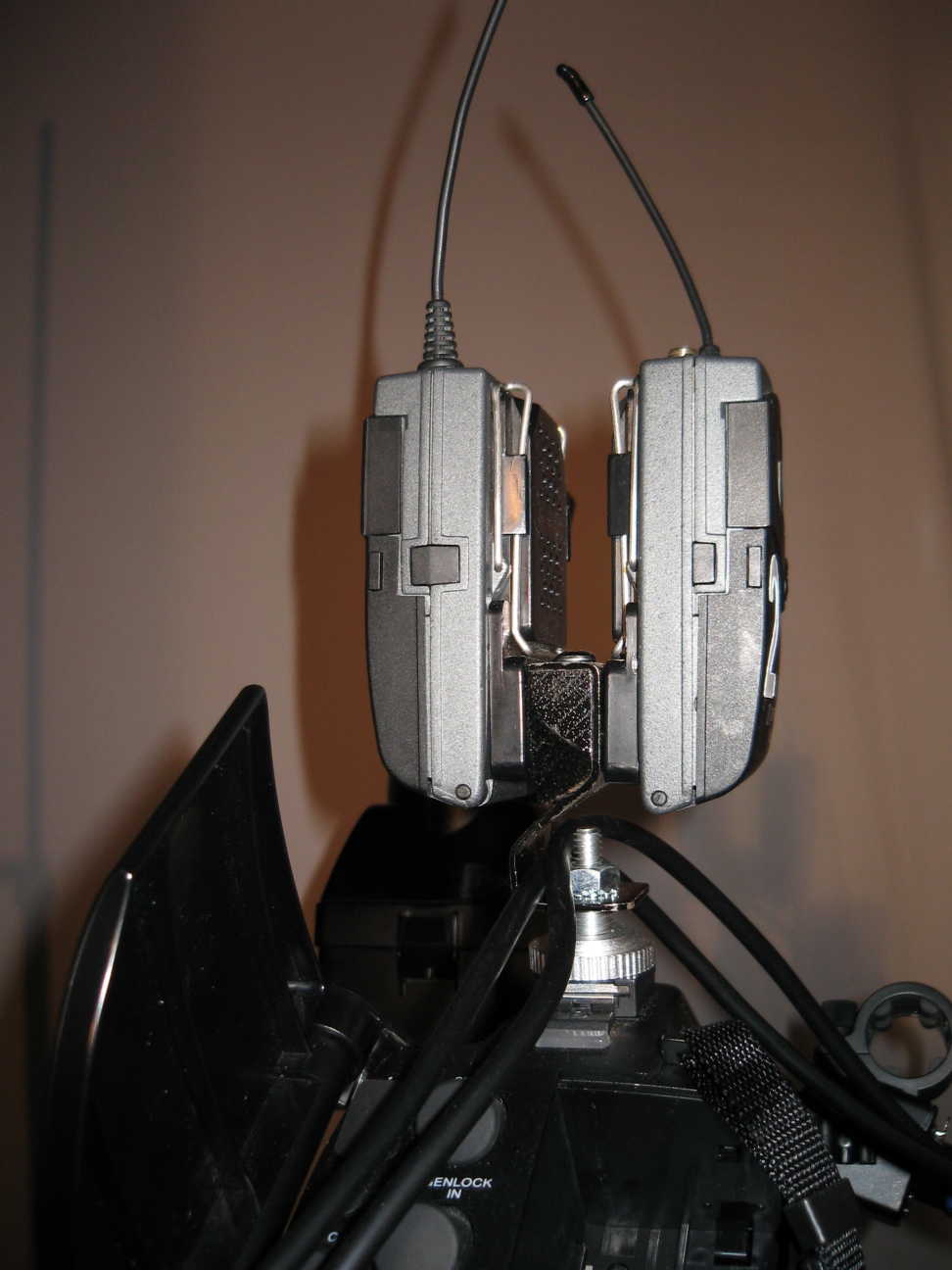

Here's how I mount two receivers...
Using 2 Wireless Lav Mic's/EX3-img_0062.jpg

Dude!! Looks like a great solution! Is the threaded mount a Sennheiser part or ?

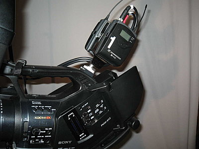

I made this. Actually it was for one of my old SD cameras.
The Sennheisers have a mounting bracket to which the receiver snaps into. I bent a piece of steel, and used a bit of wood as a spacer and mounted the Sennheiser brackets with small screws. The threaded shoe adapter is easy to find at photo shops.
I think I could re-design one so the receivers would be closer to the camera for better center of gravity. Also by using the rear shoe you keep the weight more towards the rear of the camera.
Using 2 Wireless Lav Mic's/EX3-img_0063.jpg

Nice job!!
