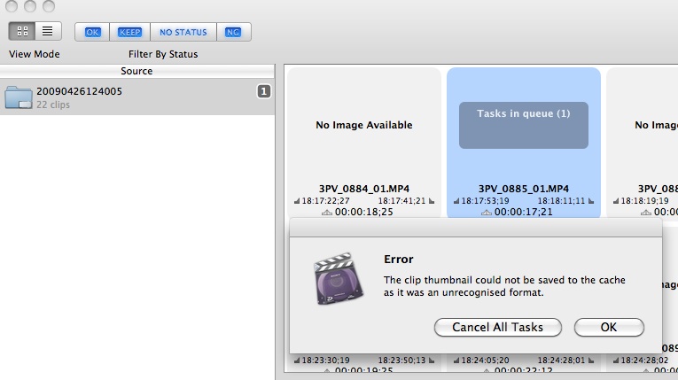

Hi Paul. I got the exact same thing on MacPro I just update to Snow Leopard
XDCAM Transfer 2.10.
I even tossed prefs, cache, thumbnails and reinstalled.
I also created a New User and same issue. That means it's a system level issue, not user file corruption or conflict.
Here's screenshot.
Originally Posted by Paul Vlachos View Post
Experimented with it on an old machine.
It will recognize a Sony SxS card via the Sony reader hooked up to a MacPro via USB.
It will not generate thumbnail files and, in fact, spits out this message, along with a box that let's you cancel all tasks: "the clip thumbnail could not be saved to the cache as it was an unrecognized format"
It *will*, though, let you import clips and they appear to be fine aside from that.

BTW the details on my system with XDCAM Transfer Thumbnail cache issue I can report the following. OS Upgrade which is now the equivalent of Archive/Install which is clean as far as the OS is concerned but "dirty" as far as the apps are concerned.
Snow Leopard does an excellent job reporting app/OS conflicts (but obviously not between app and app).
MacPro 8 core early 2008 model OS 10.5.8 upgraded to 10.6. My system reported kext conflicts with my Canon 8400F scanner, SoundFlower, Sony PDWU1. I contacted the two companies that co-develop SoundFlower and they had a Release Candidate ready the next day. I removed the two other kext issues. That didn't solve the problem. So far the only app that I needed to reinstall was Telestream Episode. The current release of CyberDuck also resulted in a compatibility message from Snow Leopard and they already had a note on their site with a beta release made public that's Snow Leopard compatible. No other app, even my aging Adobe Photoshop CS2 reports issues.
Trouble shooting I also completely removed all Sony EX components (ClipBrowser and XDCAM Transfer), reinstalled OS 10.6, reinstalled ClipBrowser 2.5.1 (which is working fine so far) and XDCAM Transfer 2.7.1, then 2.8, then 2.10 (all exhibited the same thumbnail cache issue).
I also created an news user on the system and it exhibited the same issue so it is a system issue rather than a user issue which would be related to preferences for user caches. If you look at the XDCAM Thumbnail Cache folder you can see the cache for the thumbnail aren't being written so this is where the "block/issue" is.
I do suspect an app to app conflict (app to app's kext?) for some commonly used app or utility. Personally I don't think a clean install would resolve the issue unless one excluded reinstalling the unknown culprit (because I don't think it's an OS component) which is of course hard to do given it's unknown.
