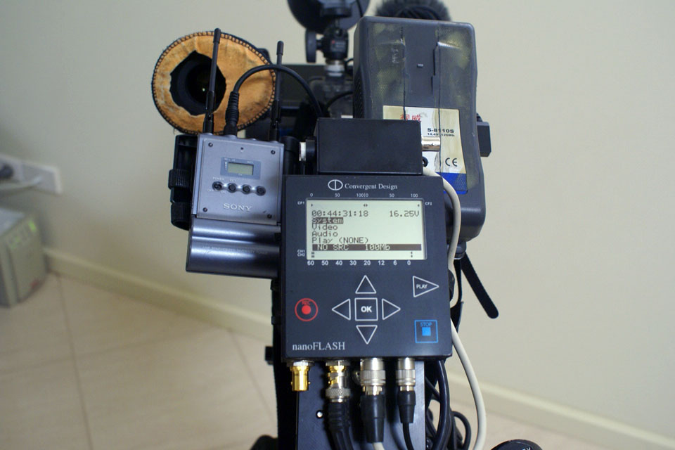

I have an EX 3 with a redundant recording system it's called SxS cards, the primary recorder is a Convergent NanoFlash which gives better quality than the SxS. One of the things to remember with the NanoFlash or any other add on recorders mostly by default they operate from the embedded timecode from the SDI signal. Should the camera stop to recording to it’s cards the NanoFlash will also stop. The NanoFlash is equipped with a remote port and I would recommend that you use the optional remote control switch with inbuilt tally light. The remote can be mount anywhere on your camera that you comfortable with. I leave mine permanently connected above the NanoFlash and the cable rolled up under the mounting plate held with velcro so it’s ready for use at anytime.
Where critical work is involved like weddings, I would set the NanoFlash to operate from it's own internal timecode and use the remote control switch to activate it separately, in case of camera stops recording. This way the Nanoflash will still continue to record and you will be saved. The other thing that I have learnt is that the compact flash cards are a lot more robust than the SD cards and very few reports of problems. You can buy them at most photographic stores where ever you are. With the release of the Sandisk 64gb pro compact flash card which I found I can now buy at about half the price of SxS 32gb will make long form work a lot easier. This is a fantastic system I can highly recommend the NanoFlash. I have attached a picture of my setup.
