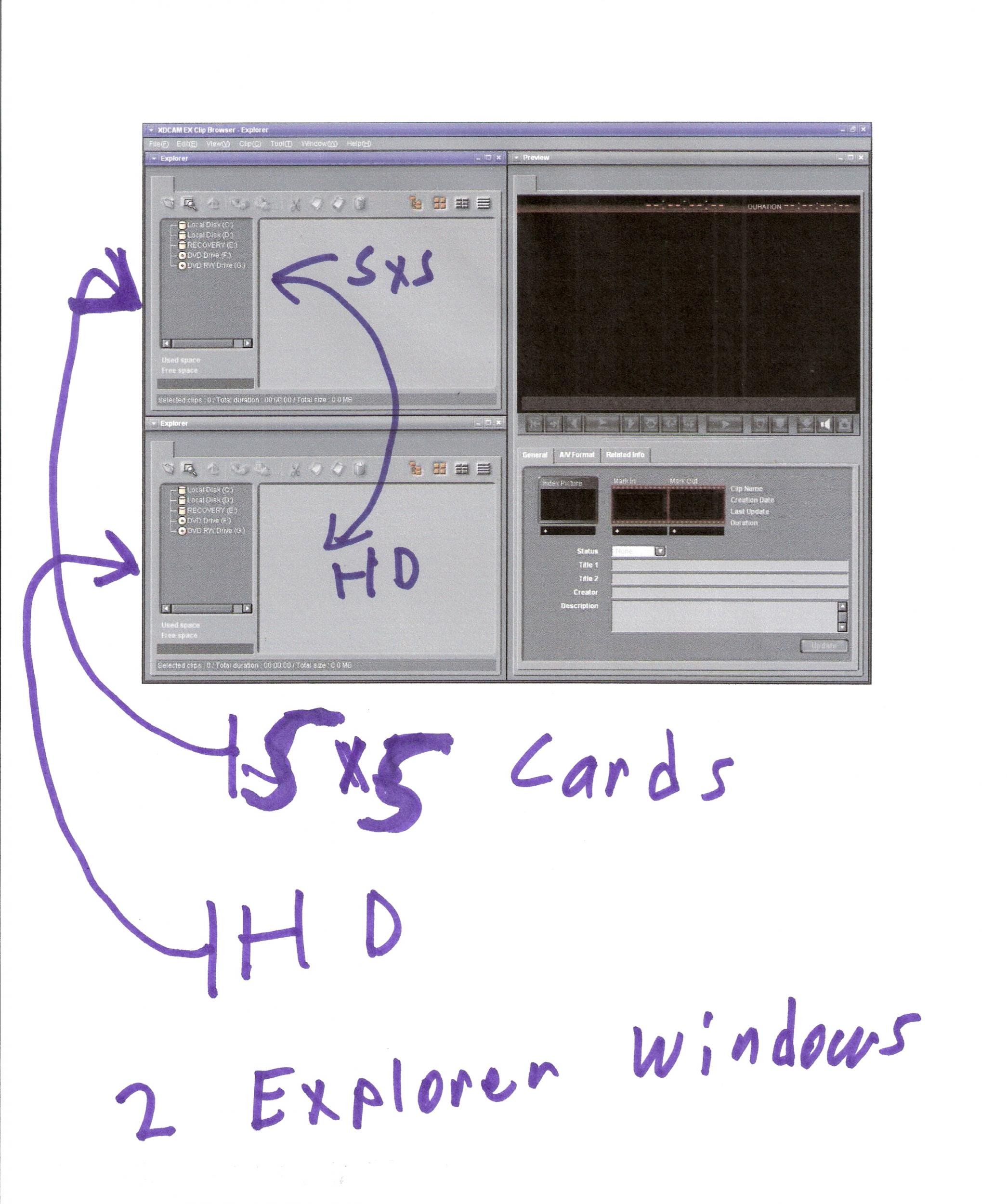

Ok are you saying to use "drag and drop" inside clip browser....like this:
William,
First, do you know the Sony laptop can read the SxS card ? Please try it first. Insert the SxS card to the card reader slot and if the laptop regconize the card. You will be in good shape (please try an empty card).
Next - Install the Sony Clip Browser to you laptop - download the clip browser (you Sony laptop is running windows so run the window version not the mac version).
Plug your portable hard drive to the USB port (most standard for the portable hard drive). Your laptop should recognize this device.
I would recommend to create each directory for each card. Therefore if you are planning to use total 10 cards (even you have only 2 SxS cards). You will create 10 directories total as:
1. double click on your portable hard drive - it will open that drive
2. on top of that window select FILE - NEW - FOLDER (type card1 or whatever name you want).
Repeat step 2 for the next directory (folder) name ....
After shooting one card, you take SxS and insert into the reader.
Run the Sony Clip Browser. It will open with 3 windows: 2 on top of each other on the left side and the Preview is on the right side.
on the top left window (Explorer) it will show all the devices (hard drive which connected to computer).
When you select your SxS card (click on the card), it will display all the thumbnails for you.
now go to the lower left window (EXplorer) - you click on your portable drive.
Click on directory CARD1 (to open this directory / folder).
Now go back to the upper left window with all the thumbnails of your SxS card - right click on the mouse - Select All (all the thumbnails / clips will be highlighted). Hold the left button on the mouse and drag it down to the lower window (you will see the (+) sign) - release your left button of the mouse.
All files on your SxS are copied to your portable drive.
Typical I would create 2 copies. One on the portable drive and one on my laptop for safer. What if one failed I still have other one.
Best of lucks
Tuy Le
Many thanks to Tuy Le for his email to me.....it has helped alot.
