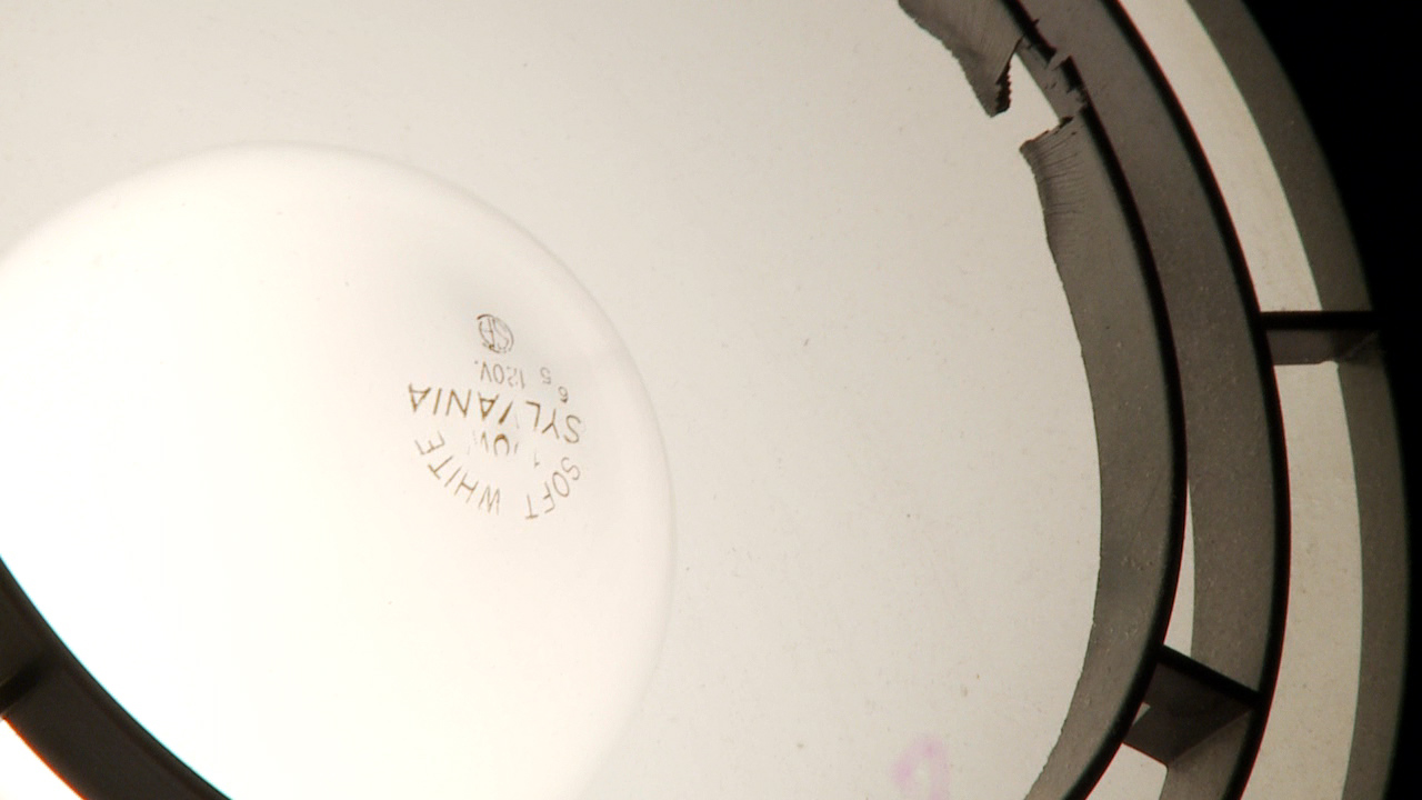

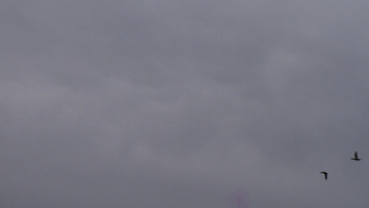

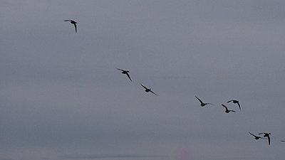

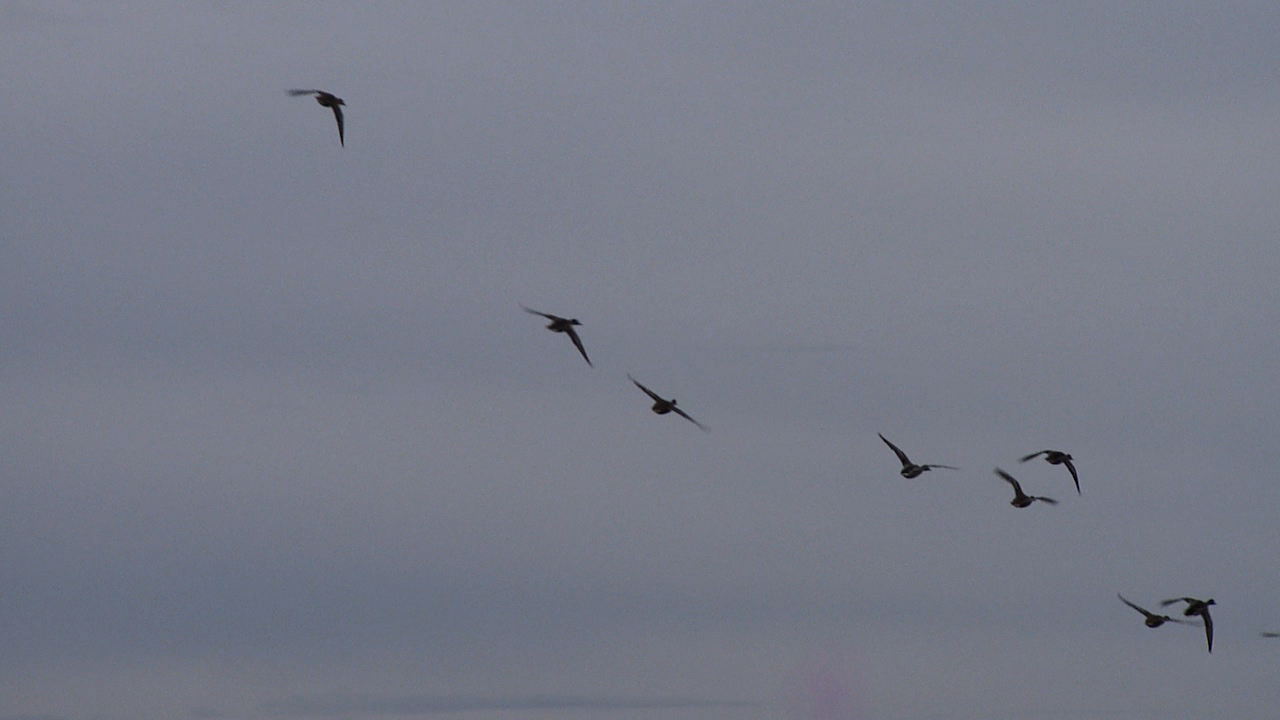

Out shooting today and found on all my clips a purplish smudge at the bottom of the frame to the right. Looks kind of like a lipstick smear in some of them. I assumed it must be something on the lens and gave it a thorough cleaning but the problem didn't go away. I'm not sure what to think. The spot doesn't move, stays in the same position, but becomes invisible over some backgrounds/lighting conditions and very visible in others. Could this be a sensor problem? Appreciate any insight. Thanks- Unedited stills attached.

Could it be a tiny bit of dust or a hair on one of the sensors perhaps ??.

Update- And the winner is (drum roll.....) Stuart Wilson with "dust on the sensor". (You can pick up your prize in the lobby on your way out).
The solution: replace the prism block. Ouch. Will hopefully have it back from Teaneck by the end of next week.
