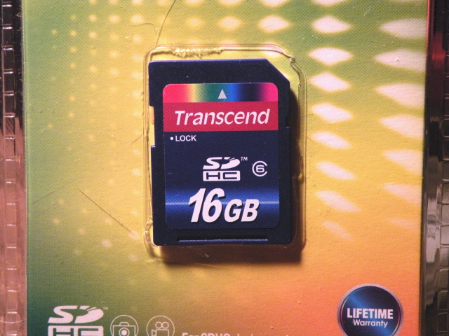

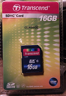

Today I got a Transcend 16GB SDHC card for a shoot I am doing this week...and I noticed it had the "Red Stripe" on it as a few posts back..some guys in the UK were saying that the ones with a "Red Stripe" on them were showing media error problems.
So tonight I happy to say, that I put the card into my KxS and then into the EX3 and recorded for 57 mins...with no errors at all. It played back fine in the clip browser. pictures below:
Info for all: Transcend 16gb Red Srtipe card-transen1602.jpg   Info for all: Transcend 16gb Red Srtipe card-trasen1601.jpg
