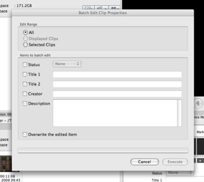

I hope batch clip meta-data editing is added.

Steve: This has been added you can now batch edit metadata across all clips or selected clips. I was told late November for release. It has to be available when the EX1R ships so users can manage the new SD and HD modes.
New XDCAM Transfer 2.11 and Clip Browser 2.6 where to find it ...-batch-metadata.tiff

...or if you can't wait that long, the XDCAM Transfer tool already allows you to enter metadata with a multiple selection of clips. This works across clips from multiple folders too.
