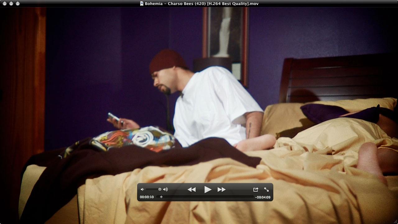

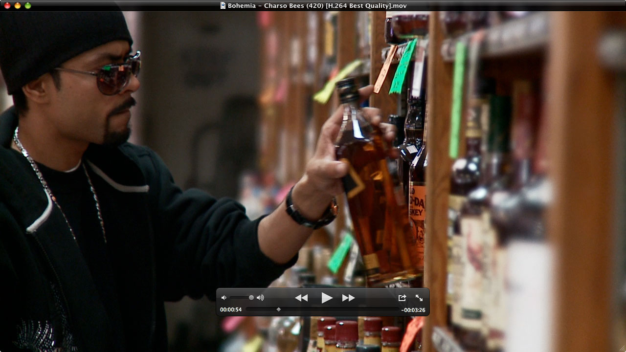

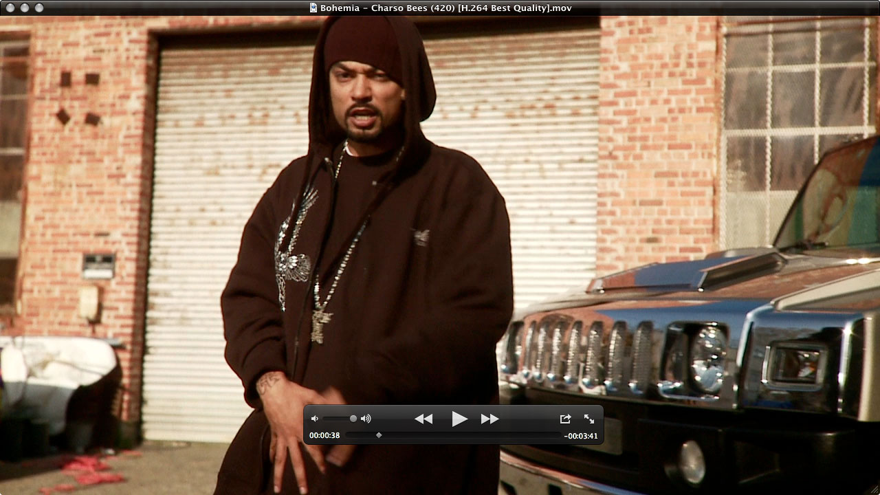

From an EX1, just wanted to share. Late 2008 model. Impossible for me to correct in FCP because of very similar background colors. Maybe a pro could have fixed it but no budget for that. Bought the 486 after this :(
Warehouse: Sunlight
Bedroom: Tungsten
Liquor Store: Fluorescent
EX3 already has improved IR cut.-sunlight.jpg   EX3 already has improved IR cut.-tungsten.jpg
