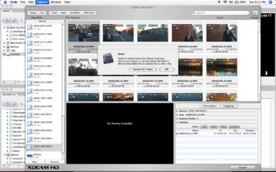

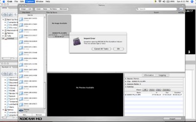

I have a clip from an sdhc card that is failing to convert using xdcam transfer. All the cards from the shoot were copied (with crc) with clip browser 2.05.01, and then those folders have been imported using xdcam transfer 2.10.0. Everything has imported fine (and I've shot with these cards many times without a problem), except one file. It copies fine with clip browser, I can preview the copied file with clip browser, and the clip plays back fine in the camera. I haven't cleared the card yet. I've attached screen grabs below of the error message (using two different ways to import the clip). Any help would be much appreciated.

Have you tried copying the clip without clip browser, just using the finder? Its a different situation but I once had a clip that clip browser would not see at all but it copied fine through the finder and then imported fine.
I assume you've tried importing directly from the SxS card right? ( sorry had to ask at least.) Also - tried copying the clip in camera to another card? I would first try every possible way of copying or importing the cards. Are you in FCP - there's Log and Transfer now also.
Also get the newest clip browser because I think they made some changes after my experience. Can't hurt.

Thanks, Leonard. Some good troubleshooting ideas in there, but none of them worked. Tried copying the clip from card to card in camera, copying using finder and then importing, and importing using fcp log and transfer. The first two yielded the same error messages as before, but the fcp method yielded a new error message, attached below, indicating an invalid directory structure. I don't understand why copying the clip in camera wouldn't build a new directory.
