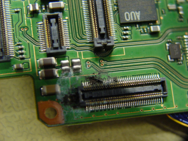

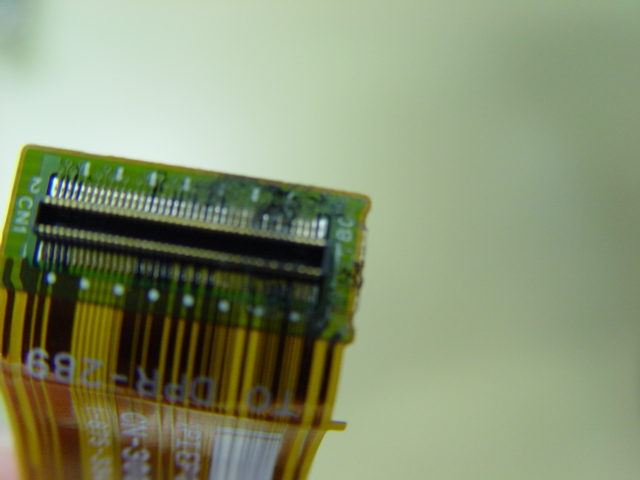

I have just had to send my Sony EX1 to Sony for repairs.
They are telling me that there's water condensation which has damaged a circuit on the board.
They refuse to cover this in the warranty.
Has anyone else had this experience and if so what was the cost of the repair.
Not very impressed with Sony on this one. Since I haven't had the camera in any extreme water conditions or places.
Water Condensation in Camera- Sony Warranty won't cover.-402738-1bis.jpg   Water Condensation in Camera- Sony Warranty won't cover.-402738-2.jpg

At that kind of cost I'd be looking to get a second opinion as to what has happened.
Looking at the photos it does not look like the typical kind of damage I'd expect to see from condensation. I'd like to know what the black furry stuff is, it looks like a fungus to me. I don't see any corrosion which is the first thing that happens when water and metals get together. It's also interesting that the damage is so localised. The black furry stuff seems to have 'grown' in between the plug and socket and yet I'd not expect to see condensation happening in there.

Originally Posted by Simon Duncan View Post
Where would one get a 2nd opinion?
Look around for someone with expertise is corrosion and/or electrical engineering.
Even an industrial chemist should be able to help. You don't need someone who knows anything about video cameras. PCB assemblies are the same no matter what they're from. Corrosion is a well understood process that's not unique to video cameras.
