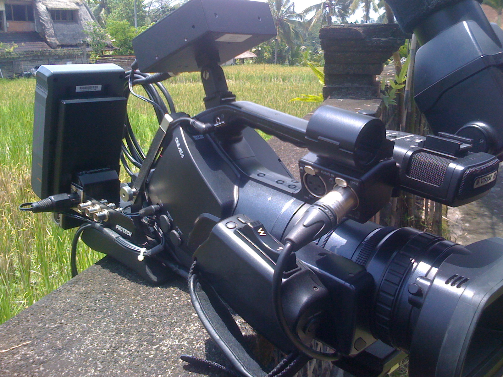

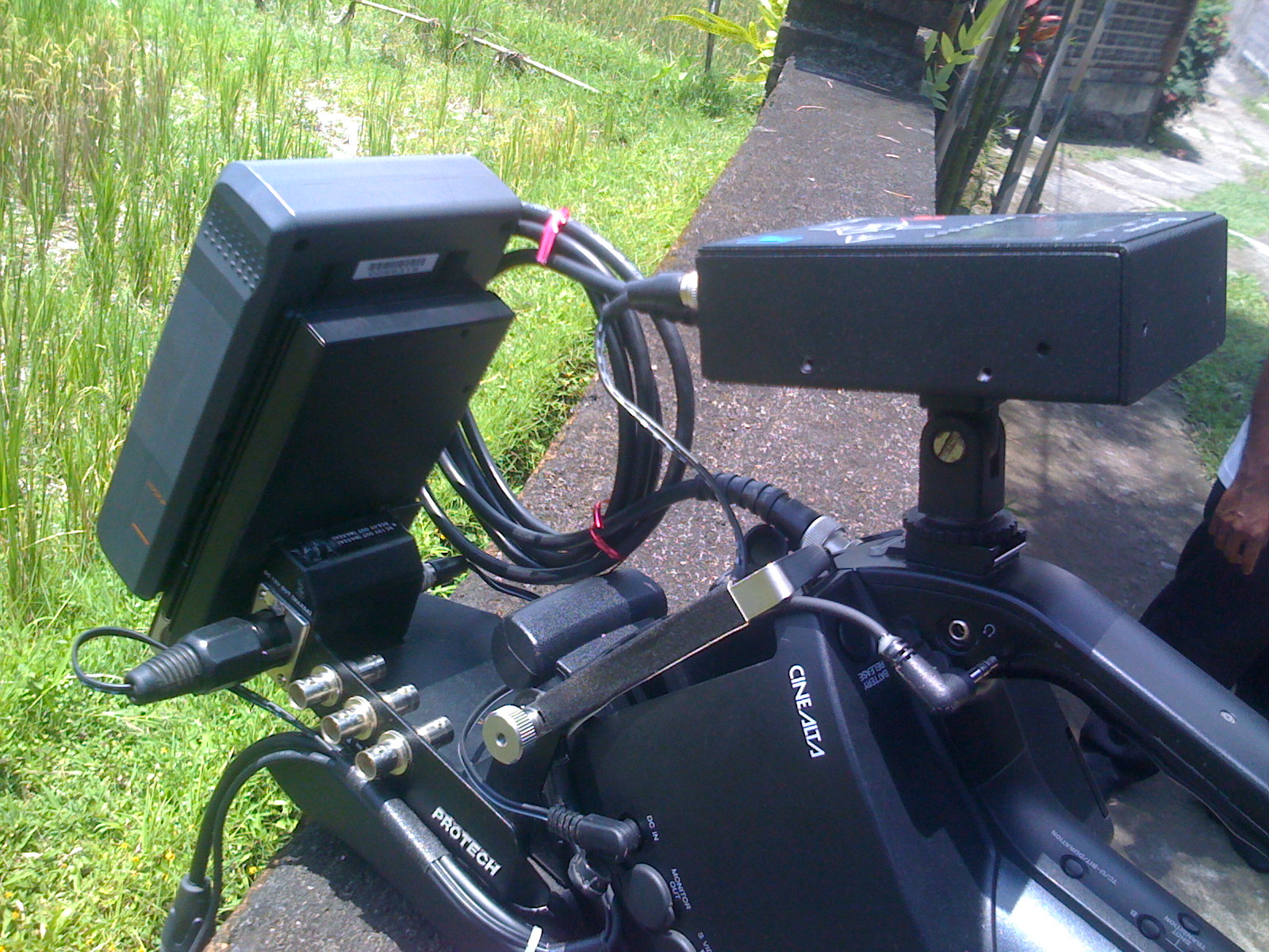

I wanted to share some pics and thoughts on our EX3 rig with the ST-7 shoulder mount and Nano Flash. I feel the rig is coming together though I'm still not totally satisfied yet. Some good things to note:
1. The ST-7 is pretty good ergonomically and it has a Sony battery mount so as long as you're using it, no need for a special mount for the full size Sony battery.
2. We made a series of breakout cables that are taped down to prevent them getting in the way and keep them safe. It's a cheap, easy thing to do.
3. Nano mounted on the back cold shoe mid-range. This is good for balance as the camera is presently back heavy. I think this position could make it easier to monitor the Nano as well.
4. The rig has a good shoulder mount camera feel while being a bit lighter than a full size shoulder mount.
Things I'm concerned about:
1. The balance is back heavy. Once I have a matte box (thinking about a clamp on Vocas as the ST-7 can't accept rails) and a broadcast lens (looking for ideas and feedback if you have favorites), I think the balance thing will work itself out.
2. Nano leads. I'm talking to CD about cabling for the Nano. They're very keen to help (great customer service). My concern is the power lead which we cannibalized from the AC adapter. I don't think it'll last as it is in rugged conditions.
3. How to power Nano if no shoulder mount? Is there a way to power the Nano Flash off the camera without external batteries?
4. What is the best cable for the HD/SDi to Nano?
Overall I think it's getting there. We purchased a Kata BP-502 backpack and fitted it out with foam rather than regular dividers which, while it cuts down on available space, does help protect the viewfinder. I've placed it in the overhead bin of a 737-400 but had to take the laptop out of the back pocket.
Hope this is helpful.
Best,
Joe

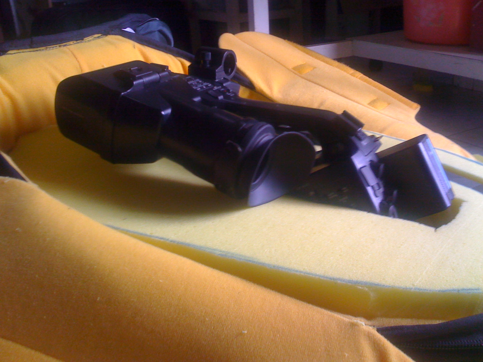

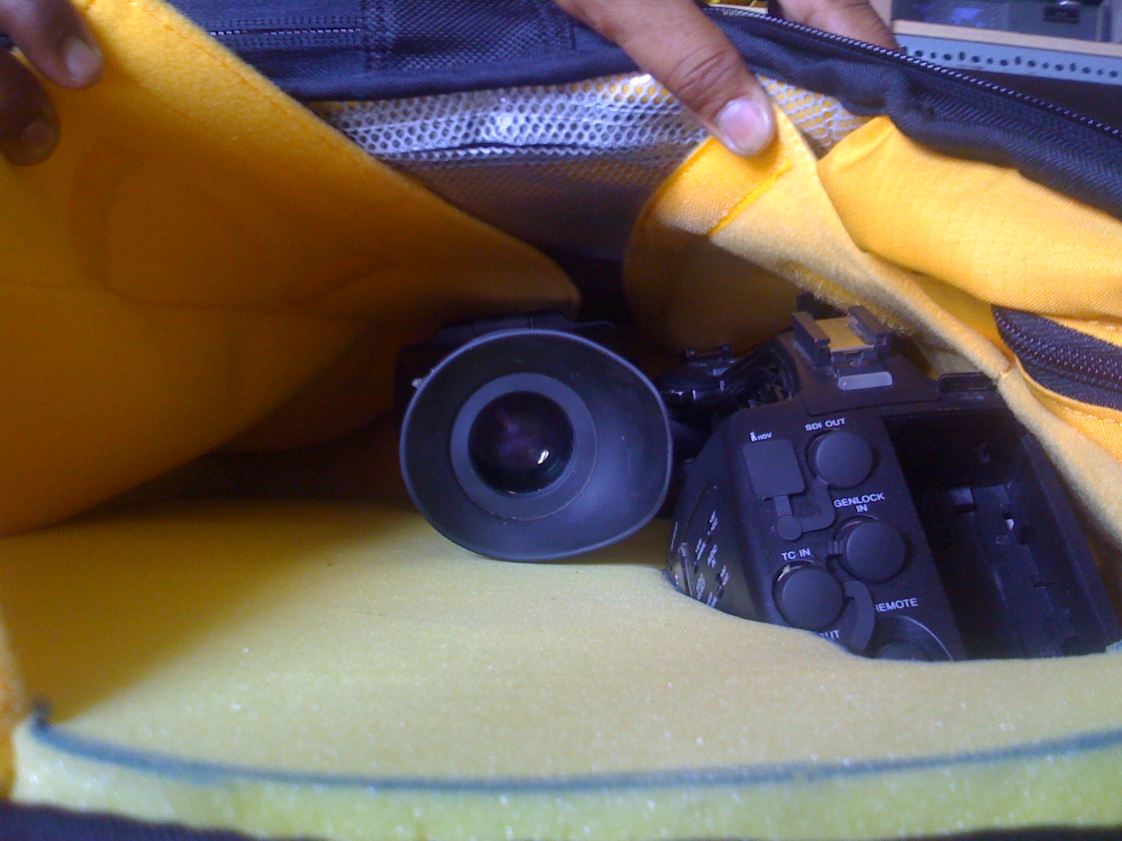

You'd mentioned in another post looking for a bag. I'm using the Kata BP-502 backpack. I got it in the overhead on a 737-400 the other day (with laptop out of the back pocket). Here's a shot:
Joe
