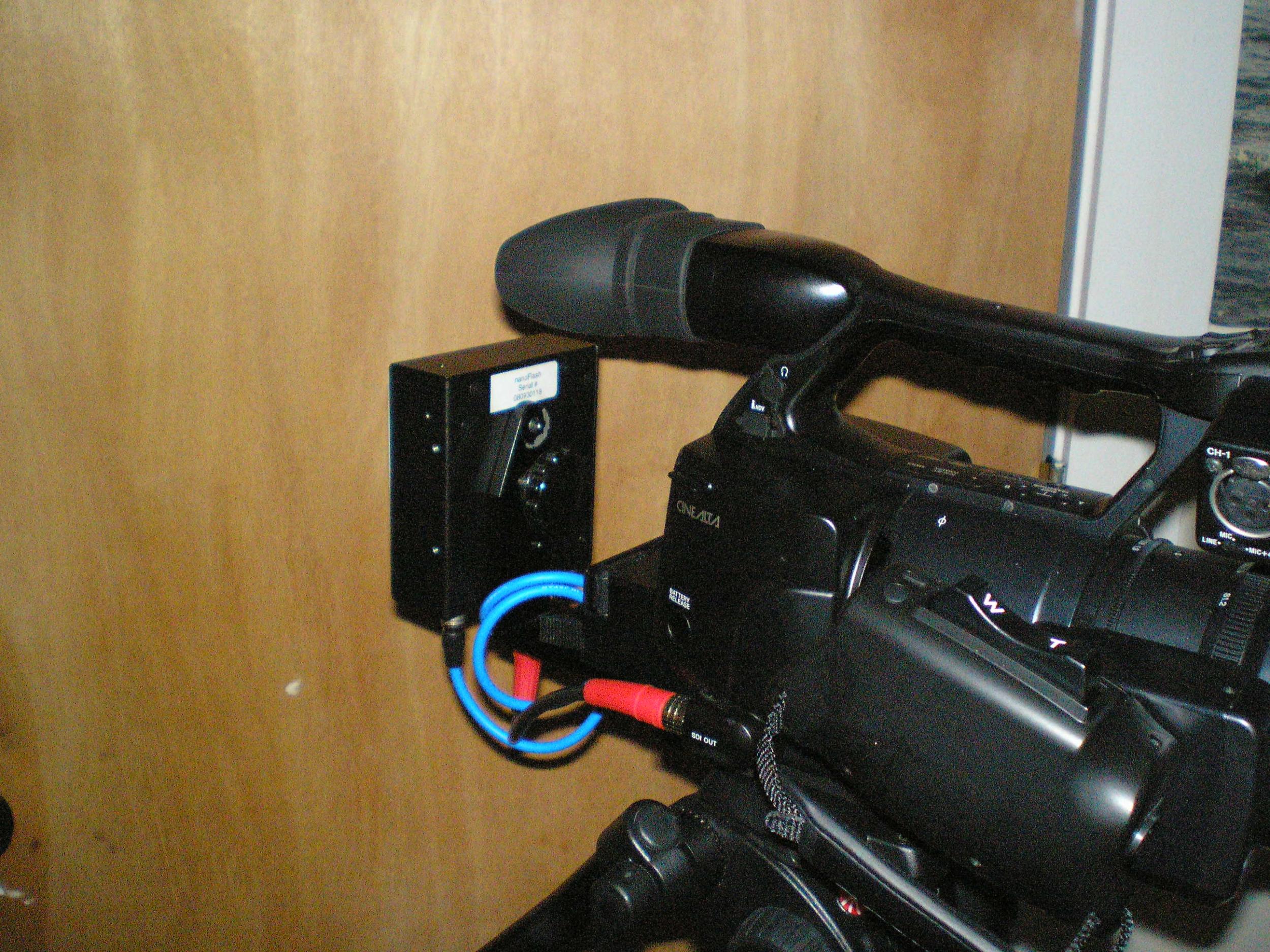

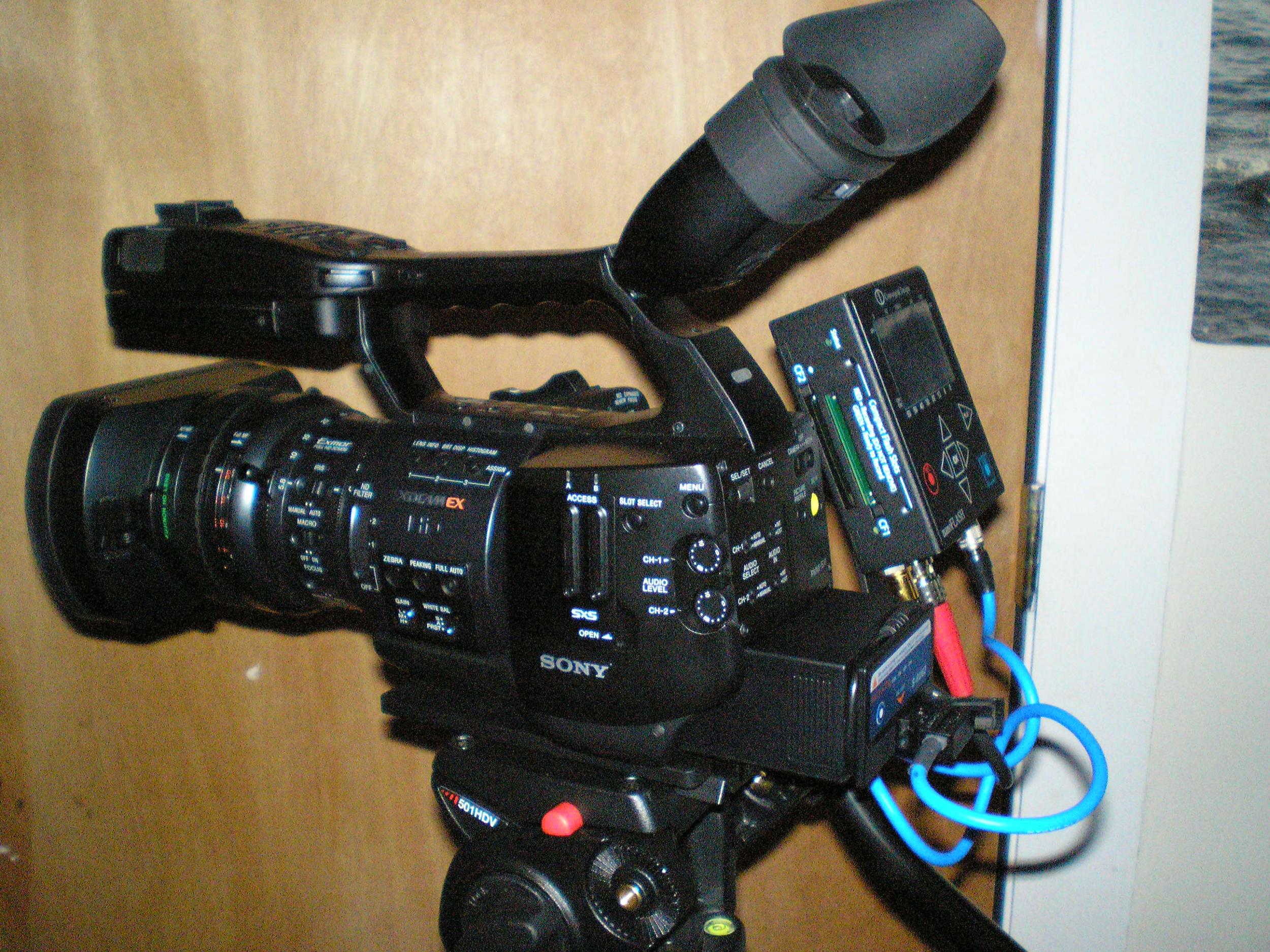

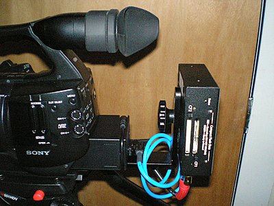

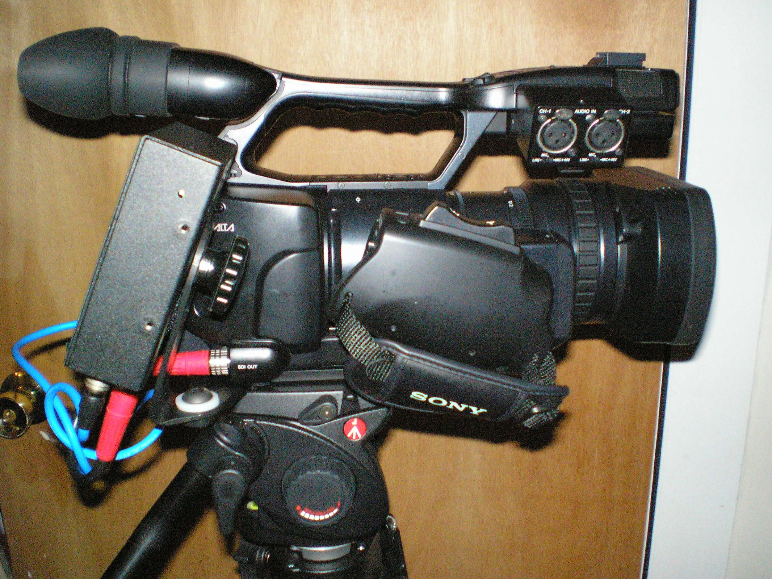

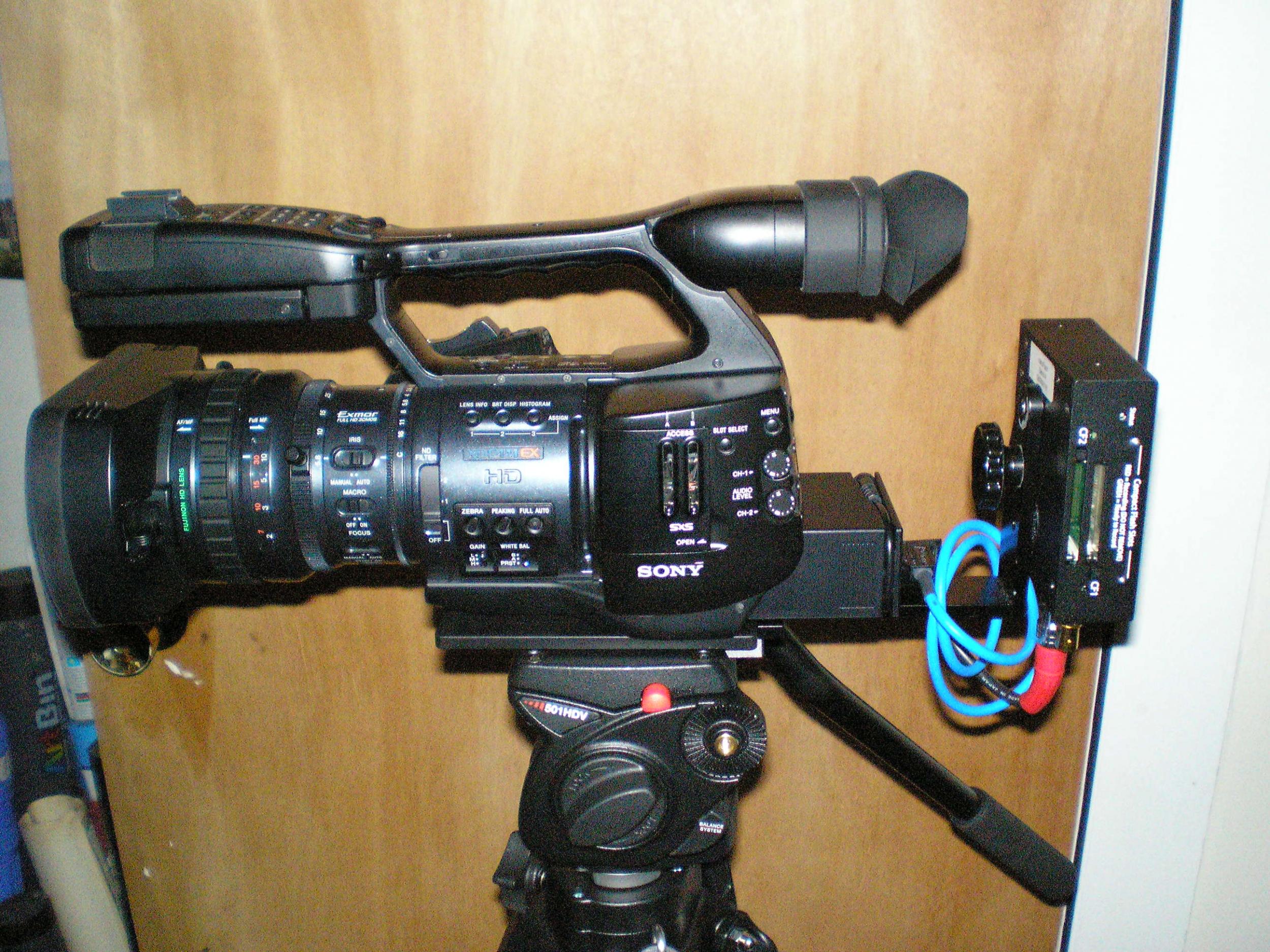

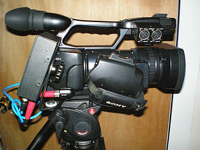

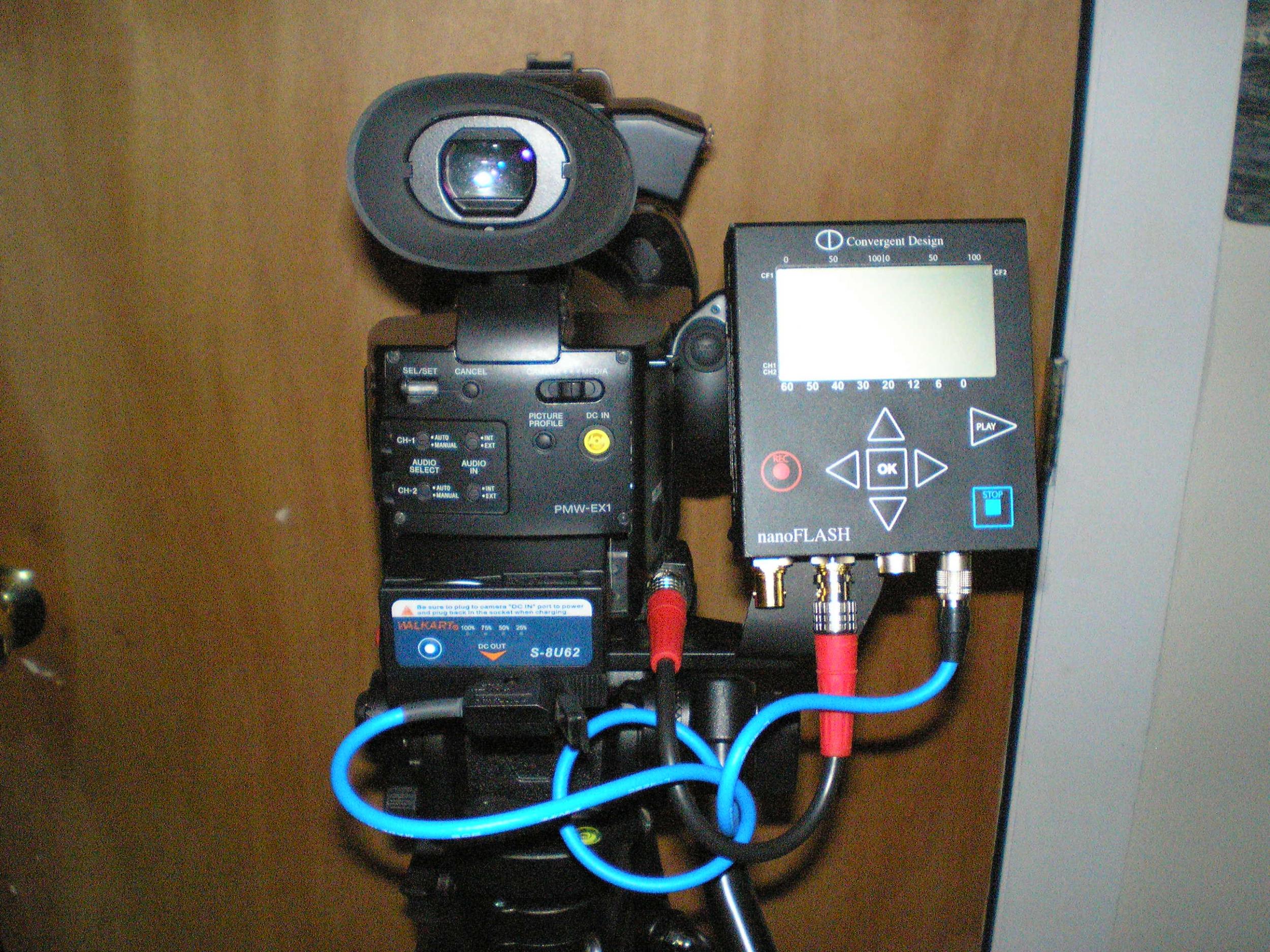

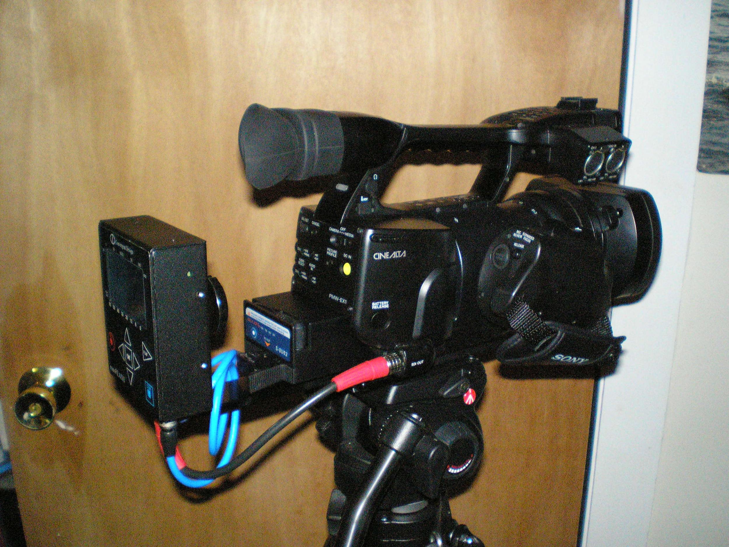

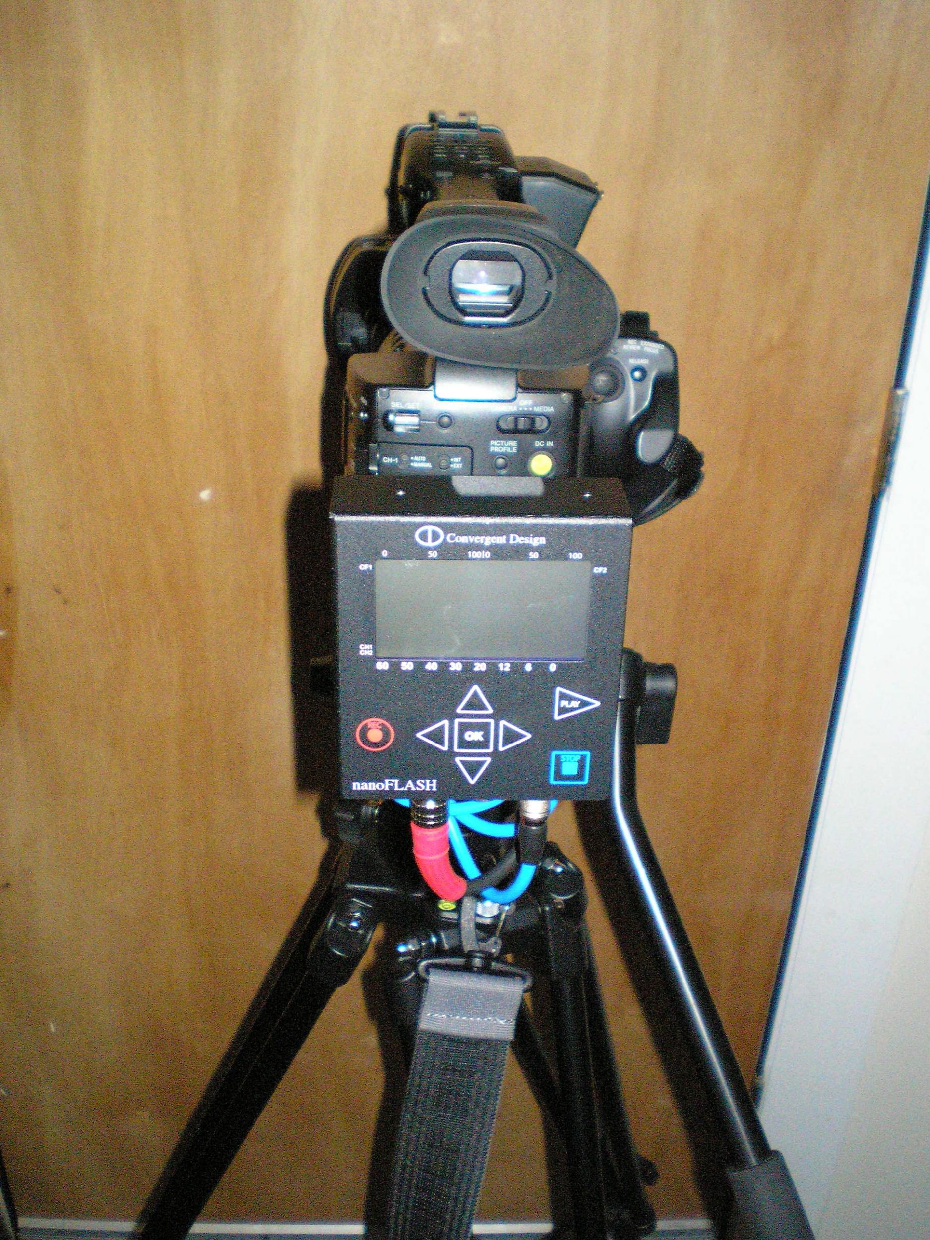

Here are some picture of the stronger bottom plate with back mount and side mount for the Nano. Side mount is great when on shoulder brace to still use the viewfinder and the back plate is great on our helicopter.
I was quick with the wires on the side mount so they are not that neat.

Thank you very much for the very good pictures and the comments above. I like the side mounted (facing back) for my purposes and I don't think I would have a problem with the power cables extending too far down to "crimp" themselves in the bag. I had a custom HD-SDI cable (9") made by CD but without the boots (unlike the red one in yours) so the wire can bend quicker. In placing my Nano at the location in your pictures I would need a camera bag at least 10" in width if I were to keep the unit on and not disassemble it. I still could cover it with plastic bubble wrap to protect the screen. I really like this system and eagerly await Olof's final design.
It looks like the compartments in the Think Tank bag are very easily configured - do you see any problem in configuring one that would fit the EX1 with the Nano mounted on the side facing back. My wires do not extend down below the camera so I don't think there would be a problem with crimping.
