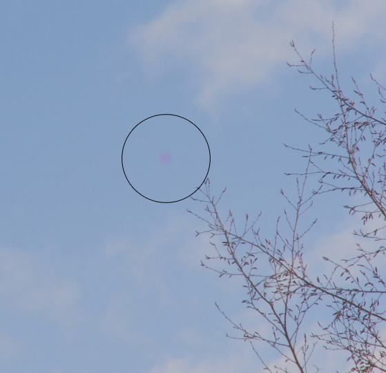

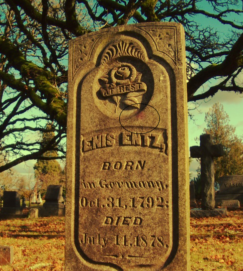

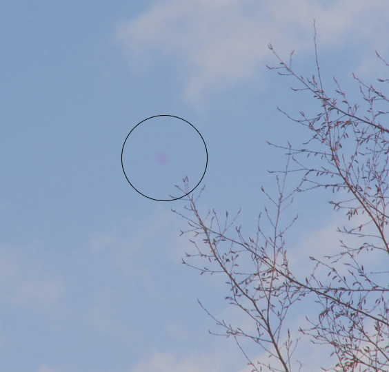

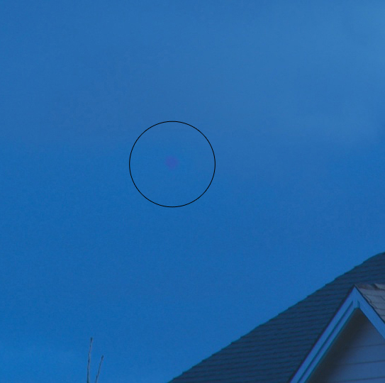

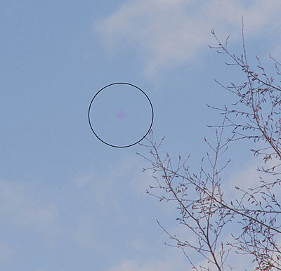

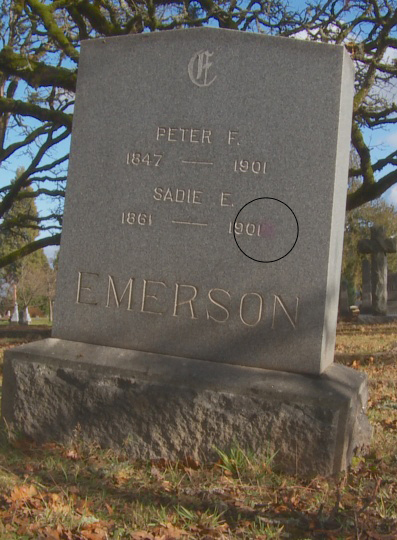

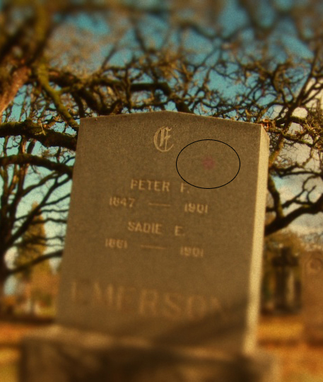

Well, looks like I have the same issue Mark had with Dust on the sensors... I had this same purpleish looking blemish pop up almost 1 year ago at a shoot in the Grand Canyon, at first thought it was a smudge on the lens but cleaned it and was still there... Next day powered it up and it was gone... not seen it since until yesterday pretty much ruined my day... I have the extended warranty thru Sony so hope that covers this. I do not plan on paying Sony 2500.00 then trying or hoping to get reimbursed.. Mark was your warranty the Sony one? I too bought my Camera and extended warranty thru B&H. See attached images.. it is strange for this issue to have been present within the first 6 months of having the camera then gone now back a year + later... I am dreading to have to package it up and pray that the unit is delivered ok (bad luck lately with shipping) I am tempted to try and schedule something with Sony and fly the thing down to the repair center myself, as shipping and insurance would almost cover airfare... Not to mention being without the camera for weeks or months is a killer on the wallet... Can not afford a backup Camera right now... This Sucks!
