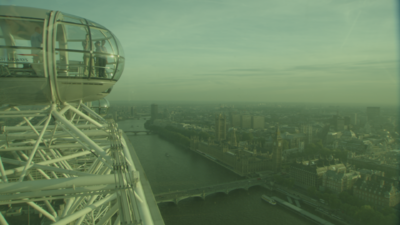

Perrone Ford December 17th, 2009 03:02 PM
3 Attachment(s)
Ok, another reworked DPX file from a Viper
Same deal...
1. Original
2. White balance with contrast correction
3. 3-wheel color + computer RGB translation

Brian Luce December 17th, 2009 09:34 PM
What on earth is that thing in London? Looks amazing.
On my crummy LCD, the uncorrected youtube video actually looks better. The blue is bluer, the back more black, and the water looks more refreshing. In the corrected version, the bg looks orangey. Just one man's puter.
Thanks for the the posts Perron.

Marty Welk December 19th, 2009 09:53 PM
ha ha, anybody shooting an original like that pic 1of4
http://www.dvinfo.net/forum/attachme...doneye_raw.png
doesnt need grading, they got an F, and should go get a real job :-)
what was someone thinking to shoot out of thier camera like that? did they have a color viewer anywhere on the premisis, do they know what the letters WB stand for?
although i admit it makes a perfect Alien Landscape, with the cool contraptions in the pic and all.
Here we are on the planet Krendar the green haze caused by the methonol chloride gasses the locals breathe :-) as we overlook the city in our cloaked observation booth, we pray that the seals hold out the deadly green toxic gasses. Our research has shown that the krendar Retina compensates for the gastly hues on thier planet, so as we observe, we realise that a real Krendarian would be seeing a normal picture, properly exposed with the colors correct.
Perrone Ford December 19th, 2009 10:28 PM
Well Marty,
That image was shot with the Thompson Grass Valley Viper. You can read all about it here:
Viper FilmStream Camera (LDK 7500) | Grass Valley
It's the same camera that was used to shoot "The Curious Case of Benjamin Button". Maybe you've heard of it.
The unique nature of the RAW capture of the Viper leads to the green hue that you see. This is normal and expected. And it happens in nearly all cameras because they tend to sample the green channel twice as often as red or blue. So if you are able to capture the image with ZERO processing, the images will always have a green hue.
Additionally, since the image the viper puts out is 10bit logarithmic, the images tend to look quite flat and low contrast. This is to be expected. And it takes some special processing to get that back to what you might consider normal or linear mode.
Most consumer cameras (and many pro cameras) shoot an 8 bit linear signal. Some of the more expensive cameras can get a 10bit linear signal. The camreras that do more than 10bit linear (10bit log or 14 bit linear) are usually well above $100k. The Viper is one of few that can shoot in that mode.
Most cameras shoot with what is known as 4:2:0 color. Or rather that is what their codecs can capture. Professional cameras are usually able to capture 4:2:2, which offers twice the color information. The most expensive cameras can capture 4:4:4 color but usually need external recording devices to do so. I believe the cheapest of those 4:4:4 recorders is about $60k. The actual media is extra. I believe Sony's HDCamSR recorder retails somewhere north of $80k, and the HDCamSR tapes are $120 per hour last I checked.
So I offer all that to say this:
Before you criticize the work of another, especially someone shooting with one of the most advanced digital cameras on Earth, and one that when set up to record costs more than most houses, you might want to get your facts in order.
-P

Marty Welk December 19th, 2009 10:59 PM
wow that camera is in a whole nother leauge.
i wasnt proposing any facts, i can (like you) understand that the imagers on this stuff probably look worse than that even, when they are raw, back behind the tricks they do to give us a picture.
i would just freak out if my camera worked that way , AT the scale of work that i do, and i would Not think it would be totally repairable.
your final repair of it still on my monitor doesnt make the city look like i would suppose it could look like with my eyes. WHICH only reminded me of times when stuff was shot here way out of wack and it was not fixable at all without laborously selecting part of the picture to process. even after the fix colors that far off still lived long after beating them down.
i mention it because after the MINOR work that we do here, i see that picture as totally destroyed. You fixed it good though, for how bad the original looks.
here in the EX forum, if you told me that an EX cam would work like that at any time i would PROPERLY use it, then i should avoid the EX cam as an option. i would not have a picture like that comming out of any camera at the level of work we do here, it is completly unacceptable.
Perrone Ford December 19th, 2009 11:23 PM
That's just it. There ARE no tricks on this camera in this mode. Zero. No processing is done to the image at all. In this mode, all you get to adjust is focus, shutter speed, and framing.
Right. But the people shooting with this camera, in that mode, are prepared for a very expenisive and often lengthy post-production workflow.
My final repair was something I tossed together in 5 minutes on my laptop. I don't have the software to do a proper 10bit log -> 14 bit color translation, as that software costs more than my yearly salary.
The difference between working with what you are used to, and RAW images, is that ALL the information is there. Look at it this way. Uncompresed HD is about 1.5Gbps. Your EX1 records 35Mbps. You've thrown away over 95% of the signal before it hits your SxS card. (Yes I know that's exaggerated, but it's representative.) The Viper is actually recording two full streams of uncompressed HD so, 3Gbps. It has so much more data to work with than we do, it's not even worth comparing.
To me, that original is gorgeous. No clipping, no crushed blacks, full spectrum video. Gorgeous! On set, the folks who need to see an example of what it SHOULD look like when corrected, have a monitor with special software that does the correction on the fly. Alternately, the shooter could put a special magenta filter on the front of the lens that would bring things back to about normal. I created a software based version of that filter (and others) for quick correction of Viper images. It takes off the green cast rather accurately. Mine isn't perfect, but its close enough for me to drop it on, and get a very good approximation of where the image SHOULD be.
LOL! Then put a $100 Tiffen magenta on it, and it will look normal color. But it will still be low contrast. You don't HAVE to shoot the viper in that mode. You can use it as a normal video camera that produces STUNNING images without that green, low-contrast look. But at that point, you've thrown away 90% of it's quality. So people who rent it, live with it being green and get all that data they would otherwise lose...
Hey, when you're paying $15-25k a week for a camera, you want all it can give you! You can fix that green stuff later...
Marty Welk December 19th, 2009 11:26 PM
and just to be sure, beings my monitor isnt "grading" quality, i popped the pic into the photo program and even according to the leetel numbers for color that it shows me, the front of the buildings is a green color still.
buildings which i assume are not green originally.
so it doesnt seem to be my wakey monitor that is off.
a fuzzy select of the colors also shows that the tree colors are in extreeme similarity to the building colors , which is what i thought when i saw that. only a real master like yourself mabey would want to get handed that and told to fix it :-)
and in that case they are underpaying you and overpaying for that camera :-)
Perrone Ford December 19th, 2009 11:52 PM
Like I said.. it's not my work. And if I had actually taken more than a couple minutes with it, I would have corrected it fully. Did you like the Chinatown finished product more? I spent a bit more time with it.
Marty Welk December 20th, 2009 12:11 AM
yes the 3rd chinatown picture looks great.
was that an EX camera?
Perrone Ford December 20th, 2009 12:14 AM
Nope, that was a Viper also.
Matt Davis December 20th, 2009 11:59 AM
Hey Marty, you a film person?
The images you're looking at from the Viper, and what you'll get from a RED and that ilk are negatives. Few people can look at a negative and see in it an emotional and deep print - and if you do, look at the shots again and see them as a contact print at best.
In this line of cameras (and with the EX line if you're really careful), you shoot for the perfect negative, so you can do pretty amazing things when you print to positive, so to speak. The 'one light' or 'machine' prints you see in the examples are just that - a quick print to ensure the shot works, without care of 'grading', 'timing' and so on.
Yes, those terms are applied still in the world of Digital Cinematography.
Shoot flat, shoot neutral, get as much info recorded.
That's how (in one example that springs to mind) in the first Narnia film, a couple of scenes were transposed Day For Night... in POST. The digital 'negatives' (Digital Intermediate or DI) hold enough information to not only pull the shot into a particular look, but also play with virtual lighting.
The benefit is quality that survives being hammered through effects shots, compositing, grading, format conversion, compression and presentation, and the sort of flexibility that enables very complex colaborative workflows - the downside is mindboggling steps of working with digital intermediates: not just long render times, but all the brain ache about colour spaces, frame rates, storage, time code, 2K, 4K, and... I think I need a little lie-down just thinking about it.
I'd also suggest reading up about RED's workflow, and how to shoot and edit with it. At least it will put the EX in some sort of perspective.
